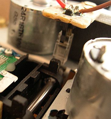

Erik van Voorst said:Okay no problem...I can always put a switch on a homemade breadboard attached to the motors...or a cleaned spare board....
I was realy interested in the easy way to determine its exact location by only attaching it to the motors.....
