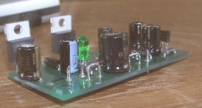

Hi Erik , newbie question here, how do you wire the super-reg?What voltage is it? A Picture please if possible. Quan.
quan said:Hi Erik , newbie question here, how do you wire the super-reg?What voltage is it? A Picture please if possible. Quan.
Here's the link:
ALWSR
Dan
All Black Gate F is gone
Very sorry all Black gate is gone
Thank you for the buyers
Has Donour me to build this transport
Regards, Jeffry
Regards, Jeffry
Thanks Dan, i like to know where to wire it in the shigaclone board.
Erik , do you use the 5V superreg?How do you tap into the shigaclone board?
quan said:Thanks Dan, i like to know where to wire it in the shigaclone board.
The ALWSR replaces the LM7808 shown on the diagram on the first page of this thread.
Dan
