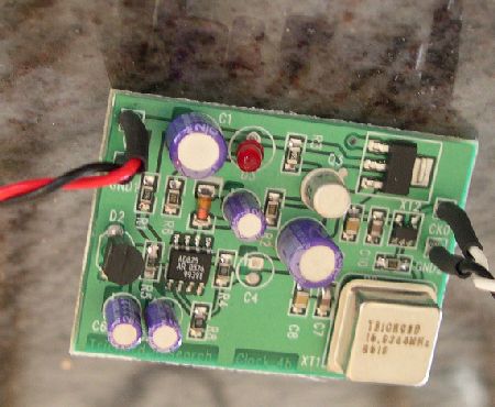

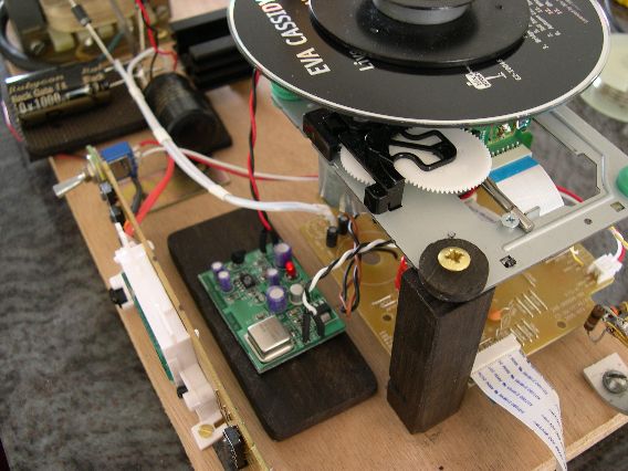

Today I really made a giant leap forward...
Despite Peter's findings with the tent clock I had a thrill with installing the Trichord no. 4 ...
At the moment I made use of the 8V reg supply to supply the clock I will build a dedicated..
(with help from my audiofriend...twice the fun !!!).
This takes the transport to the next level and is making it a serious contender for my Wadia...
The synergy and the beautiful anologue sound remains....but you get it in spades...
I used Eva Cassidy and the live feeling ...clapping hands...steel string guitar...etc gets more detailed and less edgy...
Instruments get more body...(something I thought would be only the case when supplying the chips seperately)
The Jolie Holland gets considerably more PRat (which it really needs otherwise it gets too bored)
I urge you to experiment...for me in my set it delivers....

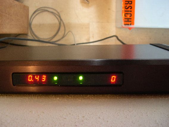

Well today i got a pleasant shock, i warn you first that this is a little long ion the tooth for some of you more experienced DIY buffs but i like pictures so Ive got a few for you.
A friend of mine turned up to day from his work travels with this for me
needles to say i was quite chuffed though i had a nice offer from Iian hay for his spare unit so thanks mate!
On my search for a compatible unit ive picked up a spare laser rack and gear plate with motors, the PCB was no good but these will do nice for spares. It also has a nice small pcb with the laser stop switch mounted to it, this is going to go on my new unit.
Motors all dismounted
And finally fitted to the new pcb
One thing im unsure of, the older motor has a PS1 type CD clamp with the bearings to hold the disc in place, which would be the better choice the puck or the ps2 style clamp?

Puffin said:Erik. Have you replaced the original crystal oscillator (E7 on Okapi's PDF) with the clock ?
Puffin,
Yes I first listened extensively to the original clock after I got used to the sound (2 weeks 3 hours a day) I replaced it for Peters Citizen which performed better...(a big bang for the buck only a dollar or so) and again took care that I got used to the sound.
Switched it today for the Trichord...that performed immediately to classify as a no-brainer......although it costs 6 times the boombox (without supply).
Without effecting the precious analog effect
(I take special care in NOT trying to build a second Wadia) nor all the other specific original elements it manages to enhance all the magic substantially and takes it to the next level in my set-up .
It is now playing in the same league as the Wadia...and still on his wooden board.

I have a Trichord Clock 3 of the right frequency in my Teac VRDS-10, which I'm planning to try in the Shigaclone. Would I be right in thinking that the clock output goes to pin 61 and clock ground to pin 60?
Yes, clock output connects to pin 61, clock ground goes to circuit ground which is the center pin of the original resonantor (which needs to be removed)
