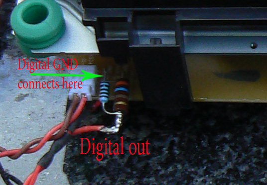

Dan_ed said:A little clarification please regarding digital output from the transport. I've read this thread at least 3 times but I'm still a bit confused.
I see from Peter's pictures that he took D-out from the opposite side of the pcb from where D-out is shown over by the TOC switch. I assume this is because of the hole that he drilled to get direct access to the pin. Are most folks using D-out for the location of the voltage divider?
See picture below...

Thanks audio1st! I tried scoping those but got waveforms that didn't match my expectations so I was even more confused.

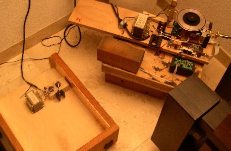

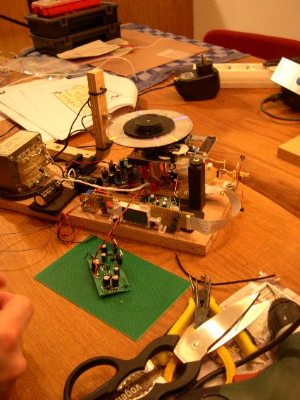

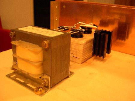

Today we finished the power supply for the trichord 4 in combination with its own 12 V Super Regulator....
In my set-up and in my perception ...It is a clear winner...😉
First Impression a lot more ambiance/air and more colour on the instruments...to tired so I go to bed...but very re-assuring that it immediately works out for the clock to have a dedicated advanced power supply...

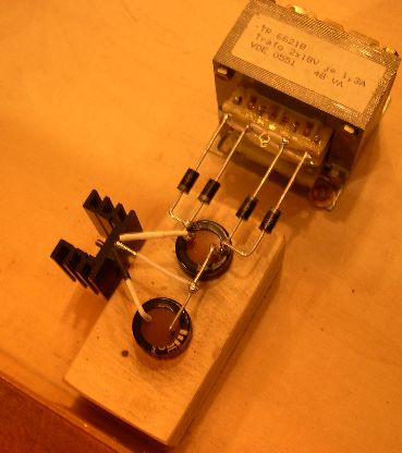

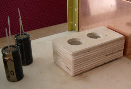

The foto shows a baltic birch block to keep my elco's quiet...
