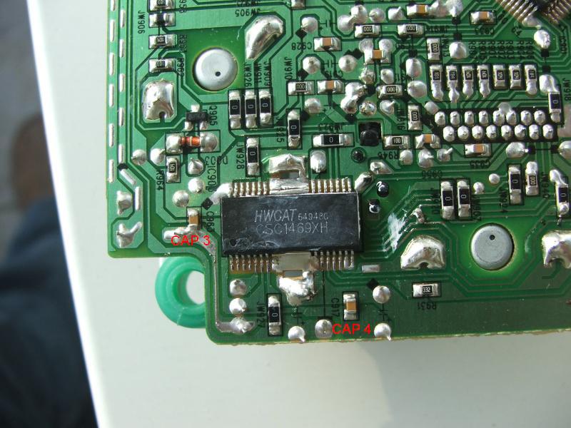

Hello!
It "works": the disk is actually spinning (some wobbling though), and there is something coming out of the DAC (I am using Peter's DAC).
However, the sound is far from clear: I can figure out a structure in the sound, but that cannot be called music.
I did all the mods suggested in the .pdf of okapi, and plugged the "Dout" and "GND" to feed the DAC, but I have not used the 2 items of A2 and A1 (2 blue resistors BERN5501000 AND BERN5503010).
I also did the jumper 5A to 5B.
Am I missing something?
By the way, this is a very exciting project. I am having a ball, but circuits are my weakness.
Thanks!
Thanks!

Are those two resistors you mention the ones used on Dout (spdif) - if so your dac may not like the nearly 5Vpp present on Dout. Use the resistors.
José.
I did remove cap 3 and 4. The only thing I have done differently was to not put the rikens.
The DAC orks perfectly also; I have been using it daily for several hours a day for the last year or so without a problem.
OK, but which should I use where?
BE RN5501000 and BE RN5503010
I cannot find references as to where these should go...
Those are 100ohm and 300ohm.
300ohm is series resistor (A1), 100ohm is shunt (A2), if you follow Okapi's mods.
That was it!!!!
I guess I had a wrong version of Okapi's .pdf because it referred to Vishay's and Caddocks so I was confused...
But it is working now, and the sound is clear: music!
This is so exciting!!!!
Thank you so much for this project! Thank you all as well for the pictures and suggestions!
Woaw!
Woaw!
