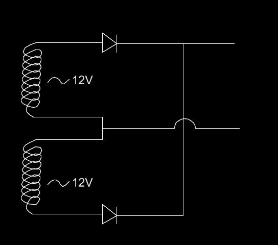

Zigis said:superhkm, PS schematic with 2x12 in post 6.
To me that is the schematics for a 24V CT.
Am I to do this : (?)
Yes, correct. This is the same, audio1st attached.
Anyway, if you have 8.13 V right now, than it must work, PS is not problem with your reading problem
Note that both positive legs are tied together. With one pair of diodes and not 2 this will produce +12 - 0. If you put the second positive leg through it's own set of diodes it would then make (+12)-0-(-12) or a 24V supply. If you are using only one leg it will work just fine, but you will have more ripple on the input side of the regulator.
Of course, use a meter and make sure that you are only putting out 12 volt before hooking things up. We want to keep that smoke inside.🙂

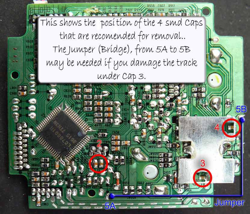

audio1st said:
Check the ribbon that connects the laser...
Did you add the bridge cable?

The bridge cable is which cable ?
The bridge cable is the jumper from 5A to 5B on the pdf of mods..
I have tried to show the smd's more clearly with the attached picture. ( Do not make the holes in the heat-sink 😉 )
No I didn't do the bridge cable, but i managed to miss cap no. 3.
Still there on the pcb. Will I have to remove the heatshield to remove the cap ?
I'm getting better at removing smd, removed cap3 and did the bridge cable.
The player now seems to work fine. will check spdif signal tomorrow.
thanks audio1st.
DaveM said:Note that both positive legs are tied together. With one pair of diodes and not 2 this will produce +12 - 0. If you put the second positive leg through it's own set of diodes it would then make (+12)-0-(-12) or a 24V supply. If you are using only one leg it will work just fine, but you will have more ripple on the input side of the regulator.
can someone please draw a schematic of this. I really dont get it.
Your schematic in post 1141 and schematic in post 1138 both are right to produce 12V from 2x12v transformer. Exactly what you need, then regulate it down to 8V.
Simply fallow schematic in 1138, this is full PS you need.
