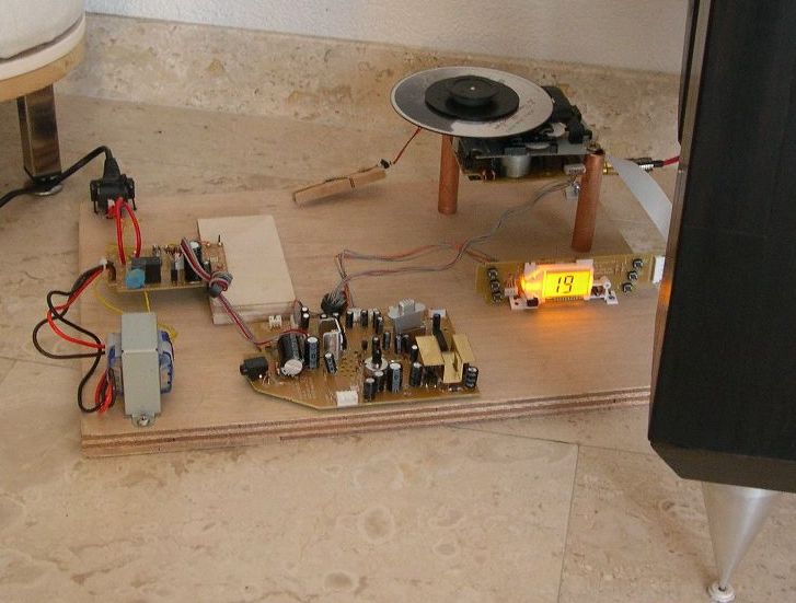

Here is a picture of my RCEZ32 based version of the ShigaClone.
Both the DAC and the transport are built into SESCOM boxes which are now sold by Wolgram Engineered Plastics.
The transport is built on a 3/16" 6016 alloy aluminum chassis plate which is mounted inside the box. Additional mass is provided by two 7" x 1.5" x 1.5" AL/bronze bars mounted on either side of the mechanism - they add about 7lbs of mass to the transport which now weighs about 12lbs.
The mechanism is mounted on heavy ~ 1/2" AL standoffs which are threaded for 10-32 screws, final trimming of height is by washers which have the same od as the standoffs.
I did upgrade to a 50VA 12.6vct transformer which might have netted a subtle improvement. I was tempted to try a Radio Shack 25.2VCT @ 2A with fullwave center tap, (slightly more compact) but decided to leave it the way it is. The transformer is internal to the transport.
Main power is always on, and power to the mechanism is controlled by the micro-controller board.
Everything has worked reliably for several months now, and it sounds really good with my dac.
It's not quite as nice looking as some of the others I've seen here, but my metal working skills are improving and I have acquired a small milling machine and will add other tools to my budding machine shop.. 😀

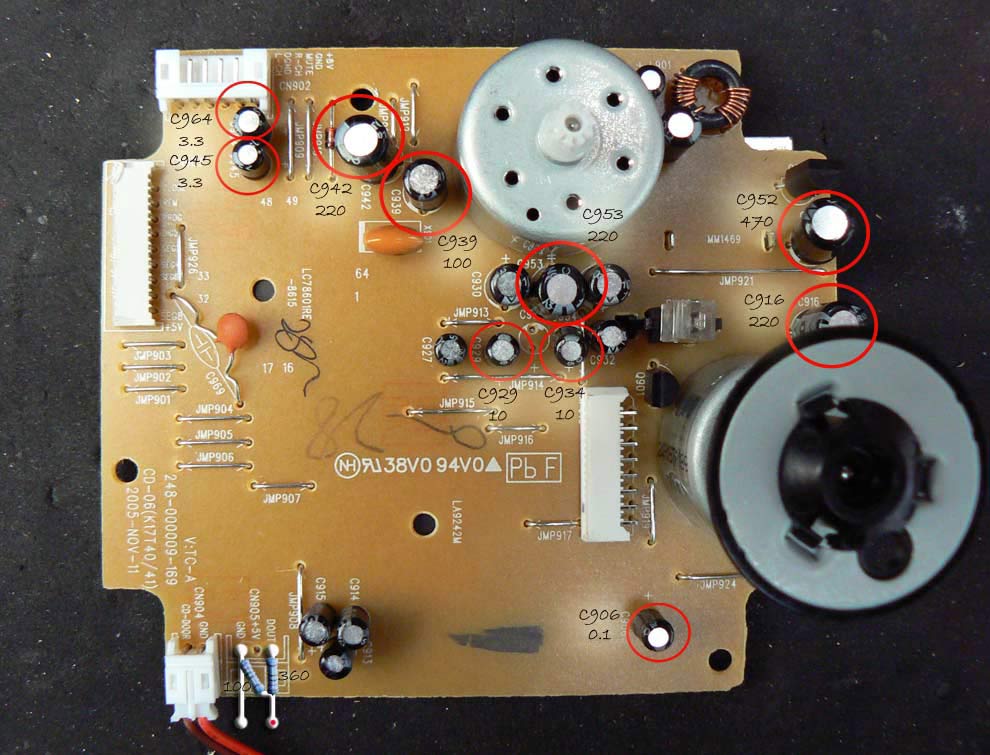

You really, really need to do Peter's mods, out of the (boom) box the stock transport is NOT that impressive. (My experience is with the RCEZ32, but comments should generally apply.) No one said it was - the key is the basically the good chipset, simplistic mechanism, and the fact that it responds extraordinarily well to modification.
The electrolytics used in this board are very inexpensive and don't do a good job. As I modified my unit I could not only hear the difference, but when I looked at the quality of the spdif signal I could see improvements in ground bounce, edge quality, and noise riding on the spdif waveform. Now it is extremely clean.
Also you are blasting the input of your digital lens and Audionote dac with 5Vpp digital signal which in most cases badly overloads receivers designed for spdif levels. (Some will not even lock at these amplitudes.) You need to add the attenuating resistors mentioned elsewhere. Standard values would be 392/92 resulting in about 1vpp at the output unloaded. (In a pinch you can use 301/100 this gives you slightly more output voltage, but is at the upper recommended current limit for the dsp IC.) This also provides the proper terminating impedances to the chip and to the presumably 75 ohm coax as well. (Important!)
