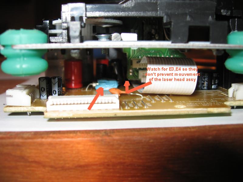

Here the side view of the modified PCB. It is rather easy to do.
One thing to take care is when replacing E3,E4 caps, make sure that the new ones to get in the way of the laser head assembly when it slides. Make sure to install these two caps as close to E2 as possible, incline them a little bit is possible.
I used blue tack to fix the new crystal and keep it from vibrating.

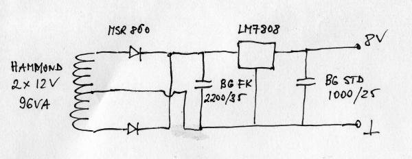

Peter Daniel said:Here's the PS schematic. I tried some popular regulators (LM317, LM2937, LT1086, LT1129) as well dual regulation and separate regulation for 5V. Nothing worked better for me than a single LM7808 from National.
I also tried few diode types, including 31DQ09 Schottkies that are supposedly used in Zanden, but again, MSR860 worked best.
Using BG STD 1000/25 after regulator is quite critical, before regulator you see BG FK 2200/35. I later switched to not available any longer BG F 1000/35 which provided more high frequency extention. You could use BG STD 1000/25 with BG N 4.7/50 bypass to compensate slight brightness but you may loose some liquidity and naturalness.
Other caps are also OK, feel free to experiment. What I present here is exactly what worked in my system (for me).
