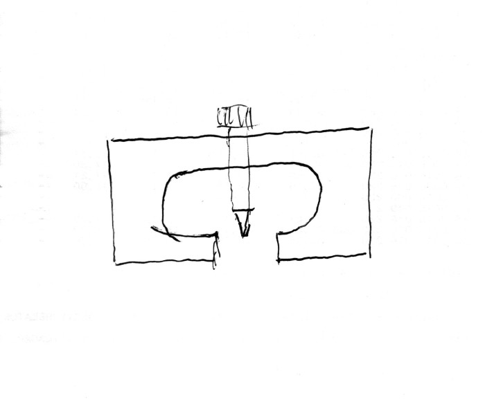

Re: clamp update
okapi said:
1. until i confirm the tolerances on the center hole and the cd shaft.
2. i heated the bottom of the clamp to 120 degrees farenheit (49 degrees C)
3. i made a puller
4. the clamp as it stands does impede screw access significantly.
1. Can you measure and note the shaft at several points, 4 at least. What´s the precision of your vernier?
2. Too risky. I would try cold fit anytime.
3. Make a simetrical one that pulls 2 oposite points to the shaft. Three points would be better.
4. Reducing 16mm ( 18-2) distance. Reducing 15mm botton diam. and drilling 2, not one, simetrically vertical access holes. Less mass, less unbalance problems.
5. I wonder how those brave polish diyers have worked this out!!
Good job btw and take your time, nobody is bleeding...
The only downside to using the snap ring pliers is that you are still pulling on the motor bearings. Using a puller as your pics show is really the way to go. Barring that, using a dremel with a cutoff wheel, you could cut the original mount down to just a thin section that would then flex enough to slide off easily. I think the idea of having a puller make the rounds is the best bet. Everyone pays to ship it to the next person in line. It will take patience, but bent shafts are not a good thing.
davem
that is potentially good news. the university machine shop is definitely not inexpensive. i would be willing to help you mail them out as well.
i will also make three pullers similar to JC's design and mail them out to speed up the process.
i found using heat to mount the clamp very easy. the temperature required is also quite moderate. having said that, i recognize the risk in a potentially "one shot" process. i think determining the appropriate center hold diameter for a large run of clamps is something best left to a professional .....not me:). also, since i have to remove my clamp from the shaft i should be able to let everyone know how difficult this is. i'm keeping my fingers crossed on this one.
edit: i should have said earlier that i used hot tap water to heat the clamp
