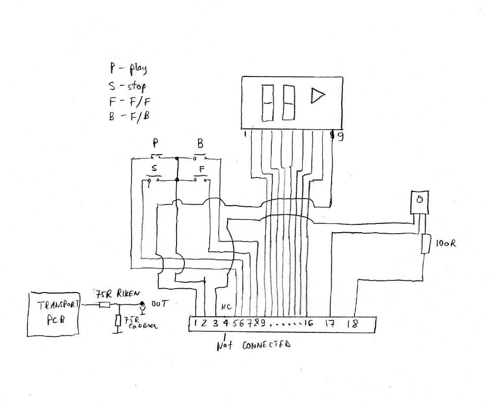

would anyone be willing to take some pics or give some advice on removing the LCD display and rewiring up new buttons? This seems pretty complicated to me and I'm trying to decide on whether I should leave things as is and integrate it into the case, or chop it up as others have done.
I'm doing just that at the very moment. I also integrating 2 new switches, Power On and TOC/Stop into the PCB, then relocating the transport control switches. I'll post pictures once done.
luvdunhill said:would anyone be willing to take some pics or give some advice on removing the LCD display and rewiring up new buttons? This seems pretty complicated to me and I'm trying to decide on whether I should leave things as is and integrate it into the case, or chop it up as others have done.
The display schematic attached.

thanks Peter. I guess it's not obvious to me how to remove the LCD. I'll stare at it some more this weekend 🙂
IIRC you need to unsolder the display pins first to remove it. The white bracket is attached with 2 screws and two clips. And don't forget about the LED, it's there too.
