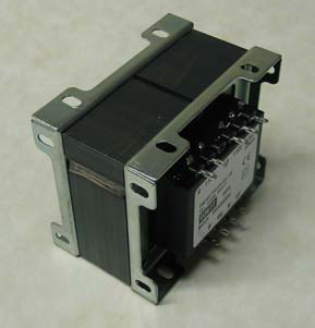

I removed and exchanged most of the part as Peter recommended. I initially used small 12-0-12V with 700mA with BGN1000/25V parallel in Super-E configuration with BGN1000/25V after the LM7808, first listening feel that the sound is not better than my CD-Pro2M unit. They certainly have more air but details that I like in the CD-Pro2M. I change the transfomer to 12-0-12V @ 6.3A......Walla....details, bass control, depth is certainly improved. I would recommend using big transformer, do not waste your time in using small one.!!!!
