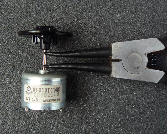

A picture of how to use external Circlip pliers to remove clamp from shaft.
audio1st. did you remove your old clamp to test a Play station clamp? i ask because i tried to remove my clamp but was unable to do it with force levels that i felt wouldn't dammage the drive shaft.

The idea of machining the hole all the way through is so that in one chucking of the part you can cut the CD mounting surface as well and the shaft hole. This will give you best results in terms of runnout and concentricity. If you try and do it in 2 setups the parts will definitely not be as good.
Make it shorter if needed, but the hole through is there for the above reasons. I would suggest getting a space of the right thickness and when mounting the clamp, press it down until it hits the spacer. The mounting height should be pretty important.
Re: CD Clamp
The hole needs to be through the full length, otherwise compressed air could make it impossible to push the clamp in.

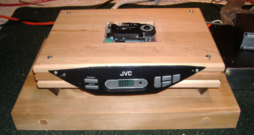

I'm in the way to build this TRANSPORT with EZ31 but
how do you make a good finish look with EZ31 control board. (PLAY STOP buttons ?)
if you have pics of finished transport front panel please ?

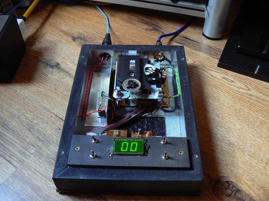

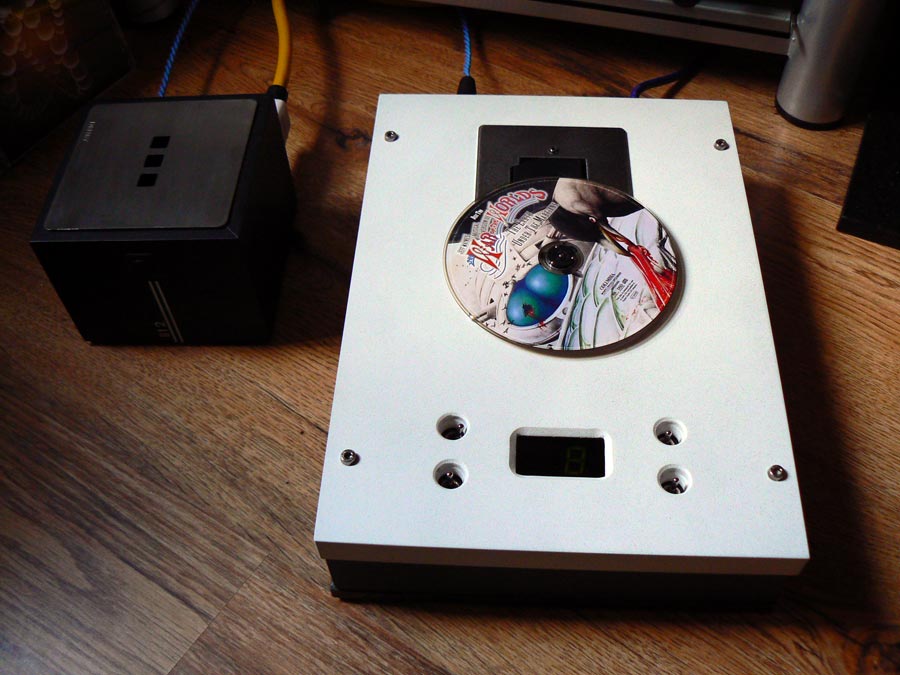

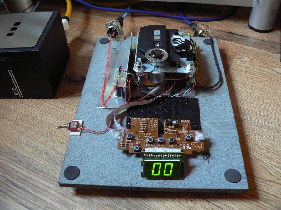

For those of you not going the Bronze and Copper enclosure route, then here is another suggestion.
I have used an old Goodmans unit for this (same chips), but it would work equally well with the JVC.
The transport is directly connected to a couple of bolts bonded to a granite board.
I also replaced the original clamp and motor for a low mass, three point clamp I salvaged from another unit.
