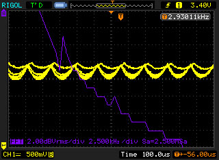

Oh and since I am continuing my rant, I thought that if we want to improve the performance of the motors, we better have a proper look at them, and decide on caps or something to fix them properly rather than adding random components.
Here is a capture of how the spindle motor looks like while playing the start of the disc...
The swing seems pretty ugly.... 500mV
Any ideas?
Any ideas?
I don t think caps in the spindle motor will affect it adversely. The negative impact reported by Eric and Jarek is probably because of slowing down the sled.
[/FONT]
Yes, that looks nasty. But it seems to support the idea that you want to separate out the digital IC power from the mech power, as you did and I plan to. As to how to deal with that motor nastiness, I'm not sure. Need to think about it a bit.
