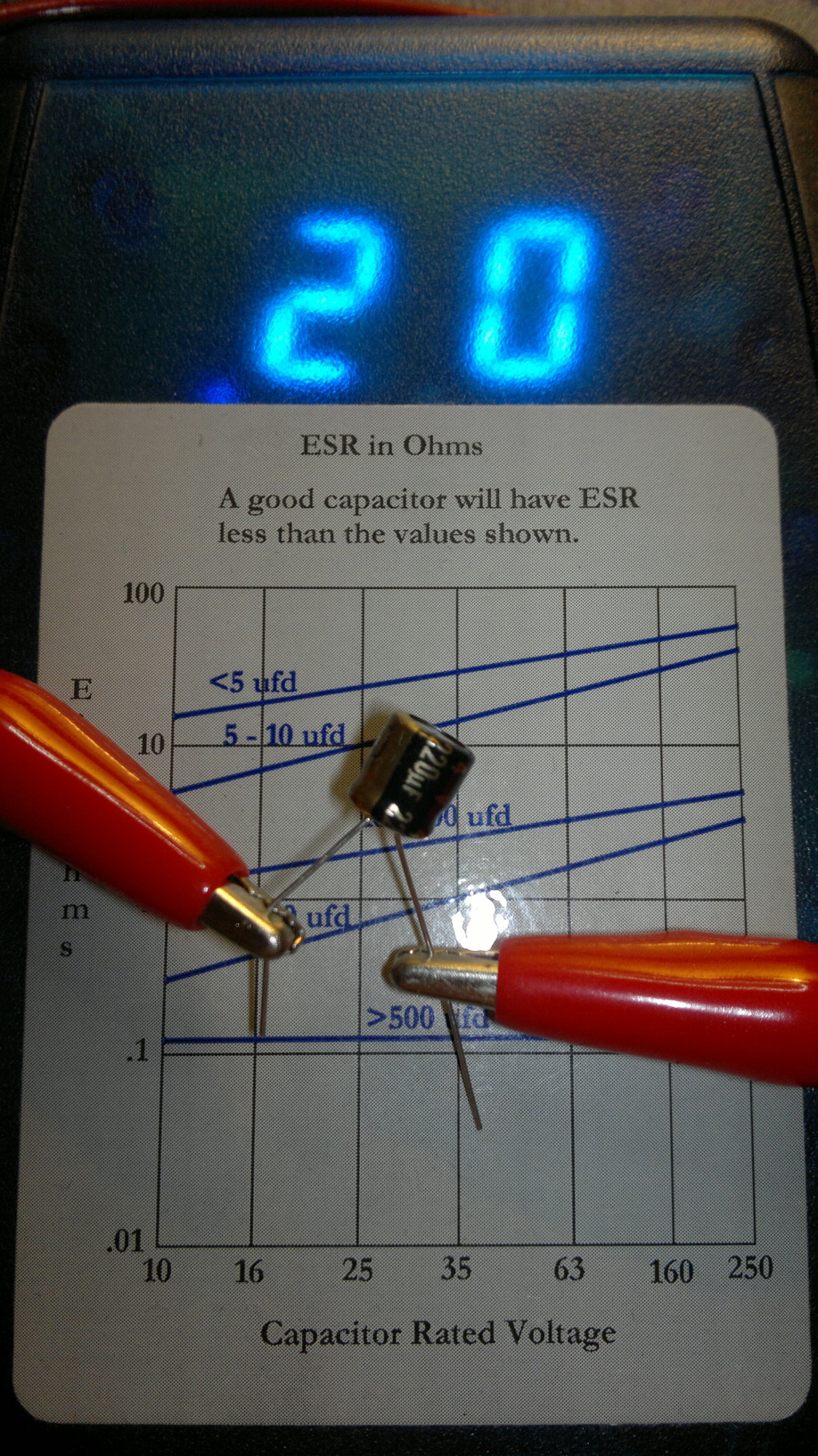

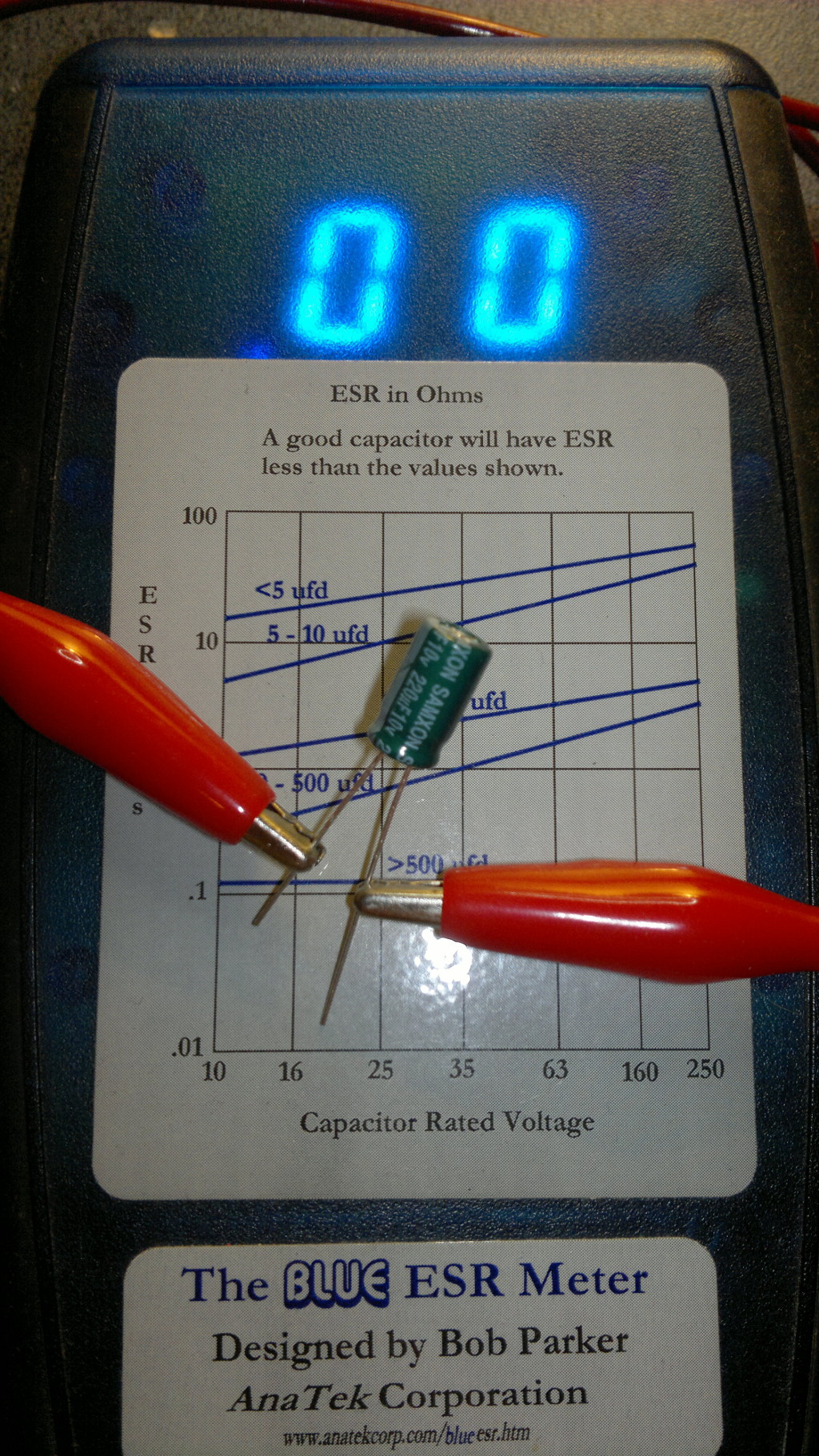

You are not alone. I was removing the infamous Samxon caps and also managed to lifted a pad
"Infamous Samxon" measure quite well on my Blue-ESR meter. I suggest to leave them in place unless you got some oscon's or polymer caps at the same value.

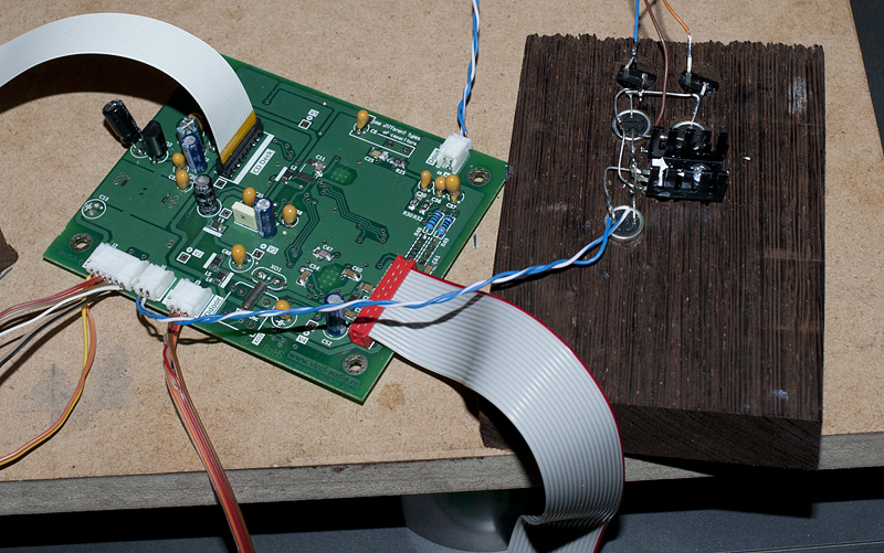

Now to the electronics part, I have tried a few stuff.
First of all, I changed the PSU of the kit with a p2p built one using 2x1000uF Panasonic FRs before and 1 after the 7808.
I have only MUR860 diodes so I used those for the rectification. (A friend suggested I gave these a try... D9E Russian Military Germanium Diode Genuine 20 | eBay)
The increase in clarity was huge even with freshly soldered and unused parts (not broken in).
At that time, I saw a piece of scrap wenge so I decided to add some damping to the entire PSU a la Eric and Jaroslaw.
The caps were stripped off their plastic wrap and fitted nicely and tightly in 10mm holes.
The diodes were fitted in 10,5mm holes and the 7808's face in a shallow 12,5mm hole, while its screw tightened it to the wood.
I know the layout is pretty crude, but it was more of a "proof of concept" trial.
The result was rather subtle and mostly textures were affected. I have a nicer layout in mind, that will allow tighter bonding of the diodes and the 7808 in the wood, but I do not expect it to have any further effect. It will just be nice to have in the final chassis.
Further to modding, I changed C13 with a Panasonic FR at 47uF (I just love these caps )
The result was much more controlled bass. Quite less boomy and better defined. But at the same time, grain appeared and mid highs felt quite distorted. At the same time, the mecha started reading stuff quite faster, but what was really most noteable is that it now stops/breaks really fast and smooth.
At that point I also removed C43's bypass (C42) and also removed C13 and its bypass C12.
This made most if not all the grain disappear. I guess the bypasses were working nicely with Tibi's caps, but were completely wrong for 47uF in C43.
I also wanted to replace C10, but it is in a rather tightly populated area, so I d rather do it when I am less tired. By the way, Jaroslaw's guide suggests removing it altogether. Anyone tried it?
By the way, moding Tibi's PCB is not for the faint of heart... It requires patience, proper tools and lots of flux to properly remove old parts, clean holes and insert the new ones.
To be honest my station (450C max) had a really rough time... In the end I ended up soldering C8 as an SMD to avoid further heating the pads and risking to lift them...
Pizza break now... and after that I will also try to separate the digital stuff psu from the motors.

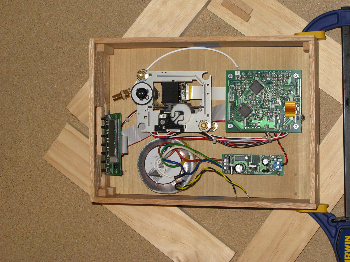

The enclosure sides are almost complete. I finished the openings this morning, did some sanding and then started putting in the reinforcement corner braces with wood epoxy. When fully assembled the sides will be screwed to the bottom moutning board. Once the current step is done, I have to cut out the top panel and then locate and cut the opening for the laser / platform.
I'm glad I'm doing the stock version first. One thing I've learned so far is that it's a lot easier to do things when you have the right tools!

Tibi, capacitor's ESR at 100kHz (or any other arbitrary frequency) has little correlation with the cap's performance in terms of sound. The noise profile, mechanical damping, interactions with other components and a multitude of other factors can affect the sound. I can bet big money that the Black Gate on your picture actually sounds a lot better than the Samxon, despite the poor measurements.

Depending on working conditions every cap have a shorter or longer lifetime.
Samxon 220uF versus Rubycon Black-Gate PK 200uF measured ESR at 100KHz.
