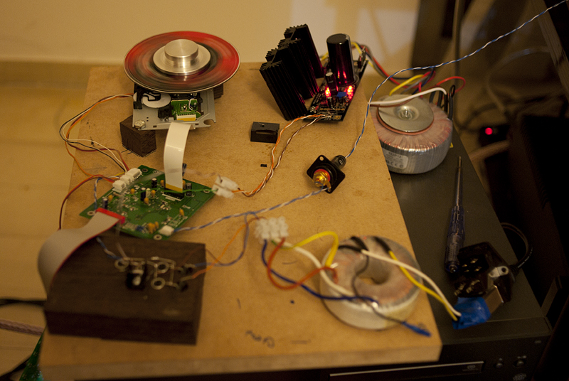

By the way, I have just removed L4 and fed 5V to V4 through a Salas PSU giving 340mA.
Results? Two words for you....
HOLLY BATMAN!!!!!!!
Clarity is in a completely new level... Like going from 300euro player into 10000euro one...
It s the biggest upgrade I have seen all day.
I did not have the chance to further test the PSU for ringing or any oscillations, but going electrolytic on its filters should keep it clean... And I have to either find a lower V trafo or a bigger heatsink, because the first mosfet gets hot really fast...
I ll post more tomorrow... it s getting late for sound tests...
Tomorrow I will also try to cannibalize the MSR860s and try them. BTW what do you think about MUR820?
By the way, with the dual PSU setup, the motors seem to run really really more efficiently. The sled moves OMG FAST and stopping/breaking actually stops the disk so fast that the puck jumps a little because of its mass/inertia
If I keep this setup, I will need to make the puck a little less aggressive towards disks to prevent scratches...

For anyone interested, attached you can find the settings I used for the salas psu.
Leds are 4 reds and one green (1,9V and 2,1V)
For R101 I used Caddock mp930
For filters I used Panasonic FRs, 1000uF in the led filter and 47uF electrolytic in the output (no zobel)
Main cap is a 10000uF panasonic at 50V (F5T leftover )

I also wanted to replace C10, but it is in a rather tightly populated area, so I d rather do it when I am less tired. By the way, Jaroslaw's guide suggests removing it altogether. Anyone tried it?
By the way, moding Tibi's PCB is not for the faint of heart... It ...
Thanks for sharing.
C10 is a very sensitive component. The quality of C10 is influencing both, laser and ASP and therefore the HF pattern quality.
I suggest to chose this part based on measurements, rather than listening.
Remove C10 and with a DSO scope make a FFT noise analysis and chose the cap based on datasheet specs.
C19 is part of laser current source. This part can not be removed and a low leakage cap is recommended. Tantalum is a preferable choice here.
You may try to replace C17 with silver-mica. This should remove some more HF noise.
Tibi
Tibi, capacitor's ESR at 100kHz (or any other arbitrary frequency) has little correlation with the cap's performance in terms of sound. The noise profile, mechanical damping, interactions with other components and a multitude of other factors can affect the sound. I can bet big money that the Black Gate on your picture actually sounds a lot better than the Samxon, despite the poor measurements.
Yes, this is exacly what I want to point out. Every cap must be used for the application for which was designed.
In this case Samxon will do a better job than BG.
BG will sound better in an audio circuit, in signal path or decoupling, but not here.

A few random thoughts after our latest changes.
Separating the digital PSU from the motors seems to have a dual effect. Obviously cleaner operation of the digital stuff and more efficient operation of the motors (if it s actual a positive influence, since Igor a few pages back was loving his slow sled)
My question now is how much of the big improvement is due to cleaner digitals and how much due to more efficient motors...
And since testing by Jarek and Eric showed that slowing down the motors with 100nF caps worsens things, my mind kind of goes towards finding more ways to make the sled even faster and more accurate.
One was already suggested by Tibi, to use even smaller polysterine caps like 1nF to suppress noise but not slow them significantly. Although the spindle motor's changes in speed are slower than the sled's, so I would expect it to behave better with the bigger cap. I will try to check the motors on the scope and get back to you if I find any weird stuff that we could prevent.
Oh and of course as Eric said, some lubrication on the plastic gears might also make things better. I think I have some thick lubricant that will not get splashed away by the speed of the gears.
One other thing was suggested earlier too. To use short twisted pair cables for each motor.
The last was something I came across reading past posts, where Tibi suggested that bigger voltage usage is possible for the motors, with the limitation that the chips will run hotter and will need heatsinks. I don t know if this is possible and within what limits, so I will need your opinion in this one before I test it.

I have applied some thick general purpose grease to the plastic gears. I like this kind of grease for plastic stuff (used it a lot on my RC car with no problems). It stays where you put it and does not run or spill, and it is very easy to wipe any excess build-up with a cloth. Plus I haven t seen it dry yet, even after many many years...
I m sure there are many specialized greases out there, so I bet you can find something more suitable if you try. Especially for the metal bar of the sled.
Anyway, the movement of the sled is now really smooth and almost silent.
On the actual music side, the effect was rather subtle but I perceive it as an increase in the speed of dynamics, more obvious in drum sounds.
Like when the ride cymbal is hit along with the bass drum in many pink floyd songs. Their timing now seems almost perfect, giving you a very nice feeling
