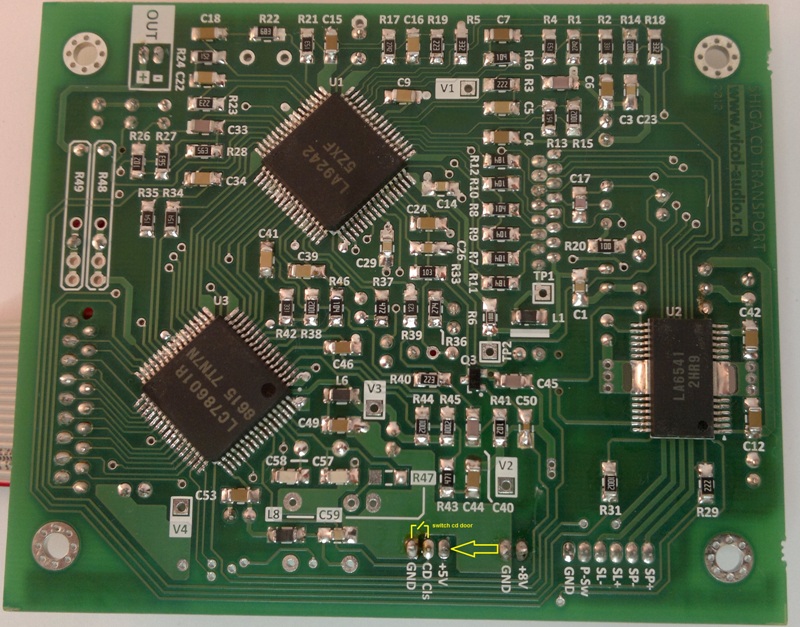

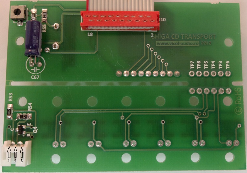

Where should I connect this + 5v, connecting to the display bottom.
Connect the + 5v to: 1 2 or 3 to the display?
Rudy

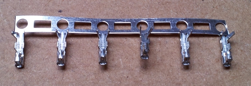

What is the name of this cable shoe, I have 4 too little.
Myself have 1 broken but I want order 20 pieces spare parts.
No good connection I must this soldering have no special tools for this.
And Yes, this connection breaks so easy 🙁
Too bad I had hoped that this cable was already made, plug in and play.
Ready mounted and tested 😉
First, go try this connection then everything directly soldered on the PCB.
Rudy

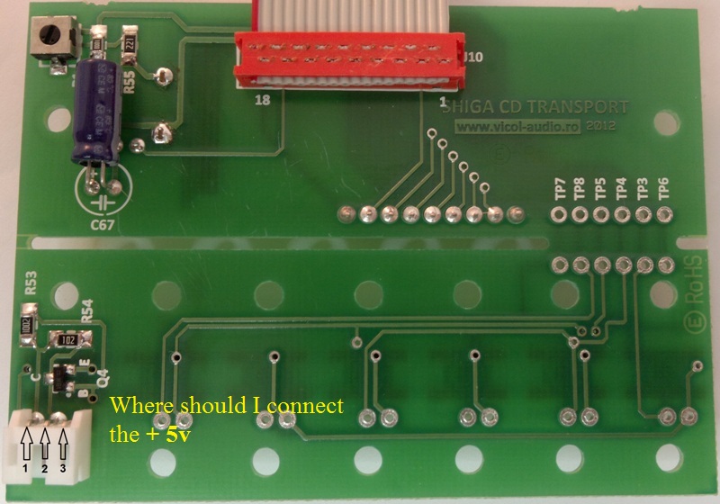

Rudy
No one can help me with this question? 😕
If I connect this +5v wrong I have a problem, I would like to know for sure.
Rudy
