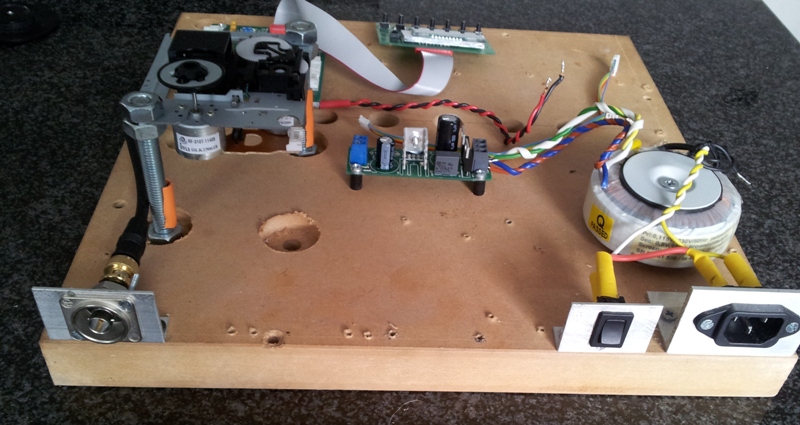

Hi Tibi,
I have the CD Puck ordered.

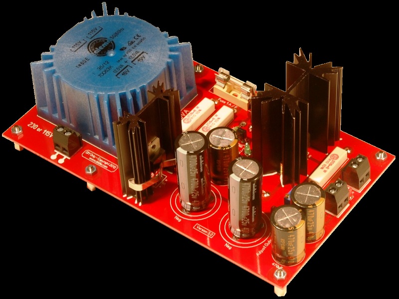

Might be an option, boards of the 5v Salas low voltage shunt regulator because dimkasta have good results with those regs.
Here a picture of Doede his site this is how I mean inclusive the transformer, plug in and play.
These are 5v 1A regs, I think that 80mA will be enough.
Only the 2 motor has more power needed.
Rudy

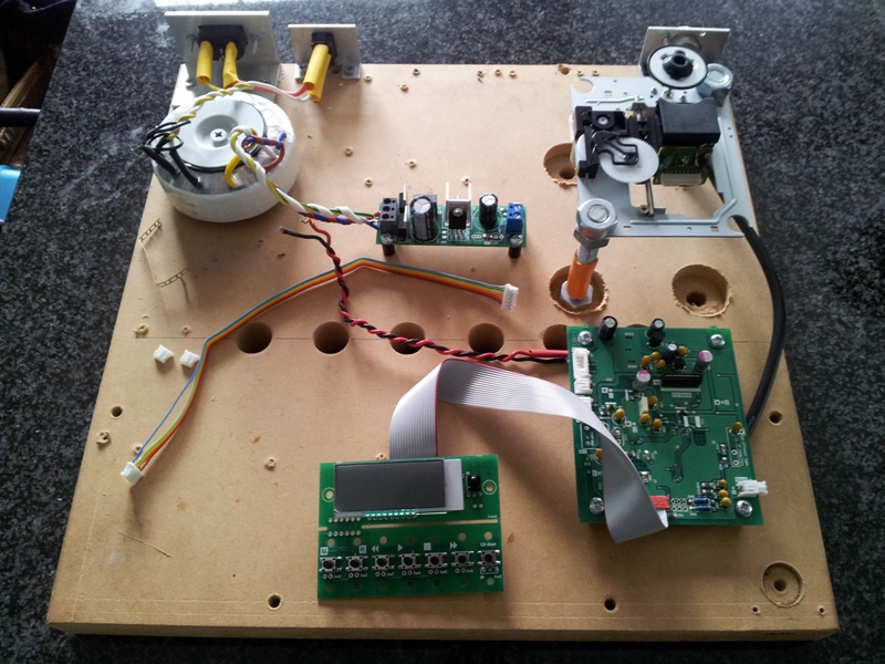

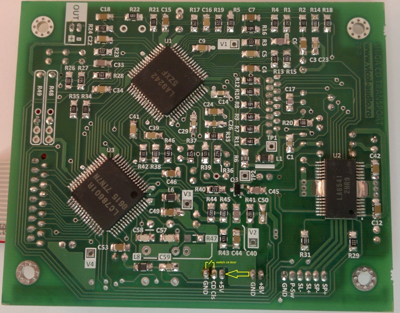

No one can help me with this question? 😕
If I connect this +5v wrong I have a problem, I would like to know for sure.
Rudy

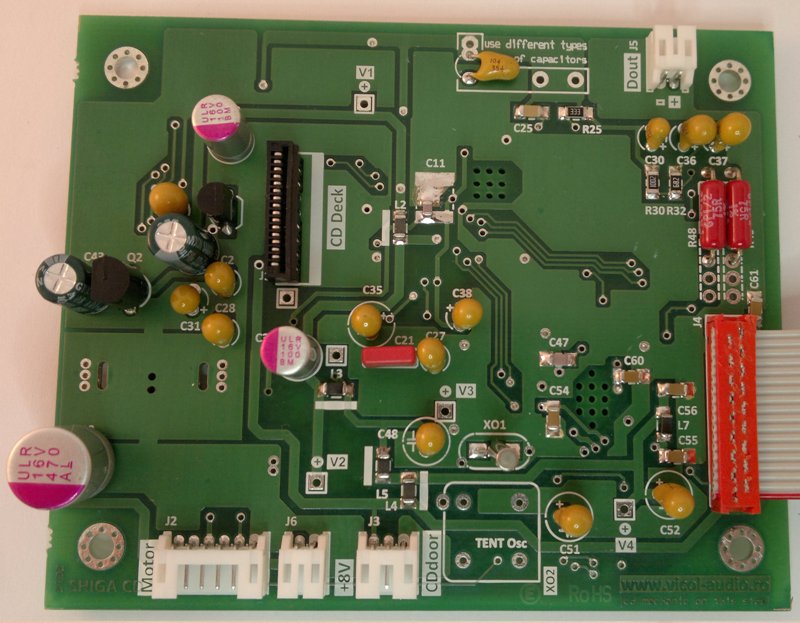

The orange wire is the 5V which connects the main pcb and the display pcb.

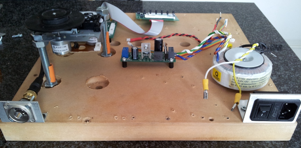

Hi Skylab,
I look again to your picture and see you use red for GND and purple for +8v 😕
Be aware you make no mistakes with diferent colors.
The other side of the PCB is +8v, on the wrong side the intention was, here the + 8v connection.
Then the error thus made
I have changes the inlet with a fuse 😉
Rudy
Rudy

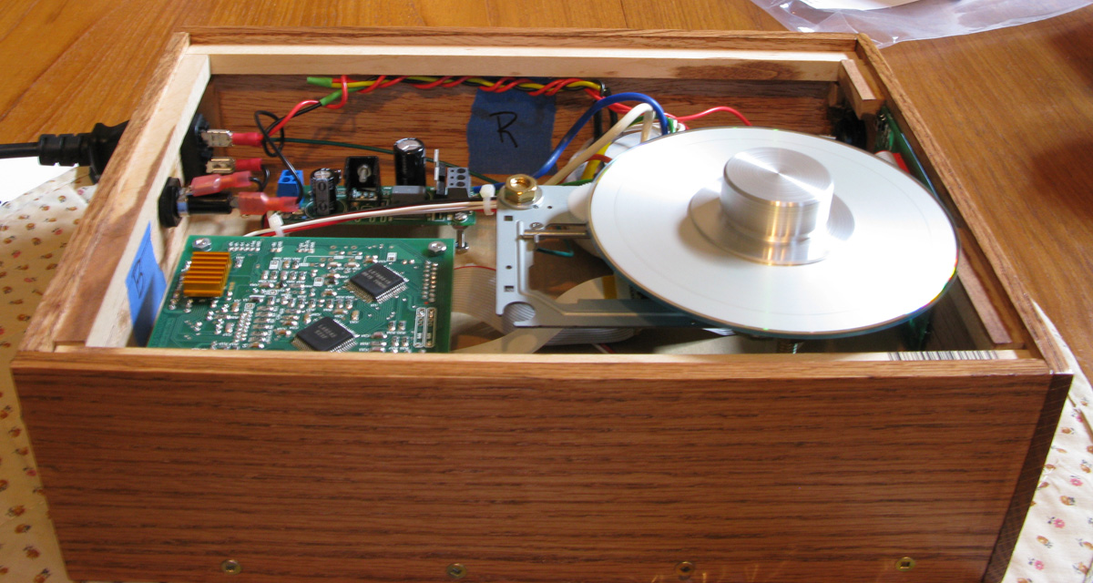

I inserted the cable in the wrong direction, the blue is +8V and reed is ground, I have marked te red cable with a black marker so I won't forget. I will make a correct cable later.

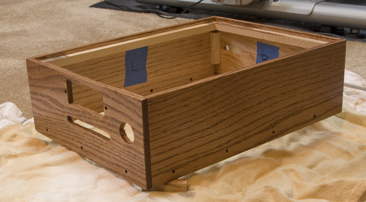

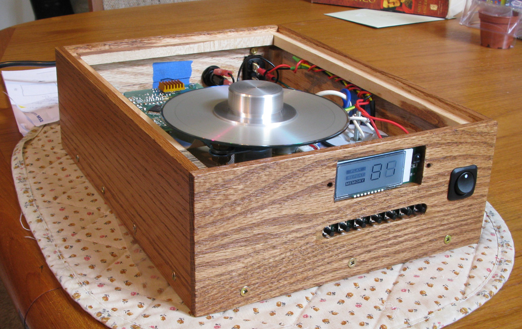

Nothing special to show, except my enclosure (sans top). It is currently drying from its final coat of semi-gloss polyurethane. I decided to stain it Cherry. Looks better in person than in the pic.
You can see that because the cabinet walls are thicker than a standard aluminum enclosure I had to cut a slot for the buttons instead of small holes - the buttons would have never cleared the wall thickness that way. I don't have a router, so I couldn't route out the backside to help.
Considering the last time I did any hobby woodwork was in high school shop class I guess it's not horrible.

All that's left is the top and attaching the lexan cover in front of the display. The lexan has already been cut, will be drilling the through holes later today. The top might be easier now that I think I have the right tool for the job.
