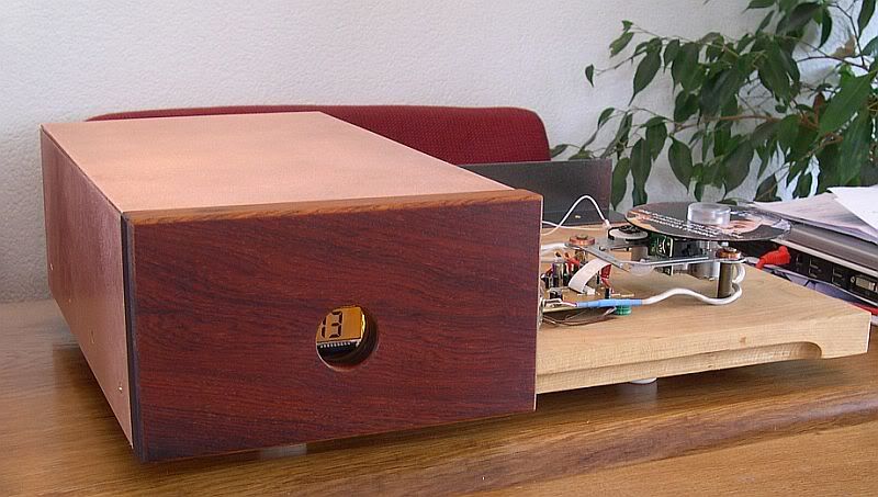

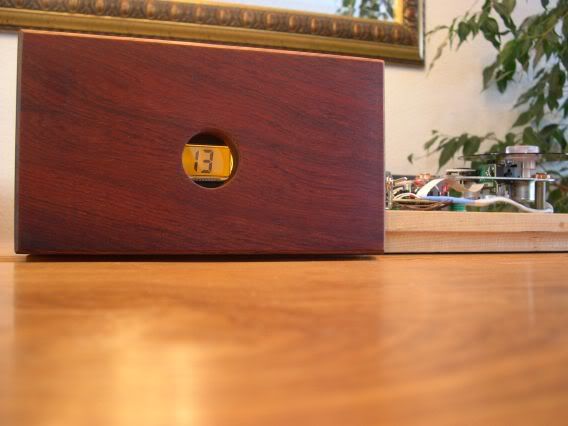

Maybe a bit sickening but I tuned the display with resistors just until I got the best matching colour with the cocobolo....😀

Looks nice Erik.....
Thanks Fran,
The idea is to give it a "2-box-operation" look but practically on one board.
The player part will be ebony and copper with a Slim-Look.
All in all a PiTbull look ....but in the end its younger brother.....since there can only be one (to quote Highlander)
Now I know why it is useless to build these things for a living....too many hours when you are passionate....even if it outperforms a lot of high-end transports....🙂

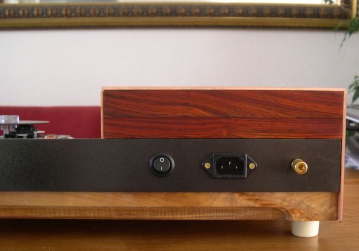

Today I worked further on the quasi-seperate Power Supply Box.
I use 3mm copper to give it a nice and sturdy finish equal to a (Mini) PiTbull.
The weight of this transport is getting seriously heavier by the day...😀
That looks really nice so far. Can't wait to see it finished.
Thanks !!
You can already see the resemblance between the Mini- and my own PiTbull.

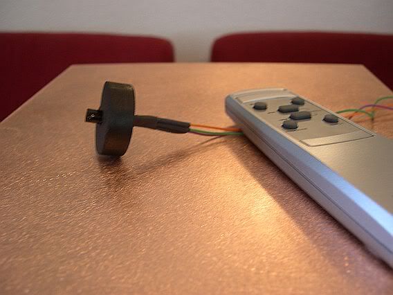

Minor setback today.🙁
The "remote control" now only worked as a kind of "close control" 🙄
Eversince the Power Supply became boxed in with copper the designed cyclop was not reflecting the commands any longer towards the inside eye .... unless you were in the vicinity of say 10 cm....
so "very close control".....a pity because I was without the extra work convinced it would be enough for future operation.
This happens ofcourse always when you have finished all the surroundings
Anyway I cannot stand defeat so from the most impossible angles I soldered the 3 wires on the display-print and while I was at it I made an ebony encasing. Now it can sit on top of the players platform and still looks okay...
No need to say that it now takes commands even send from the garden...😀
