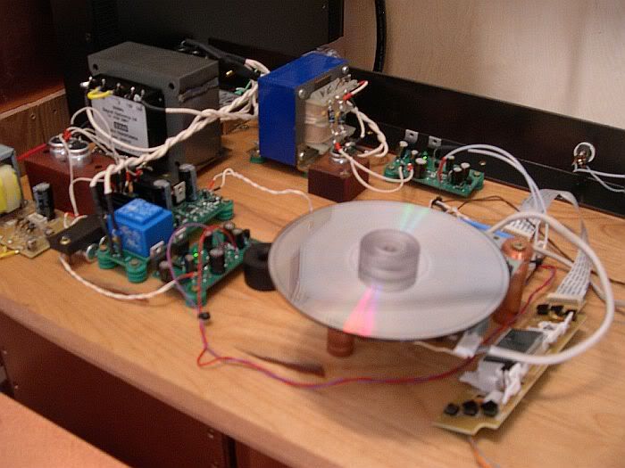

After putting the thing together again, building a solid chassis for it and putting the original short flat cable in, i still had the skipping problem.
So i made a platter adjustment tool ( same as Peter's ).
Raising the platter about 0,5mm did the job.
The help of the lock indicator was also very useful ( blue led from Buffalo DAC in background ).
So now i can continue tests with longer cable and electronics board away from motors......😎

the height between JVC pcb and transport chassis is 19mm...i would say plenty of space for this little board with output cap vertical and 3W resistor with breathing room.

The shadow of the mini-PiTbull is up and running clear ...litterally...😀
I ditched the magnet and the platform and had still a 100 percent (dearly paid in the past) puck/platform combo....a winner.
Slight disadvantage is that it now takes a bit more trouble exchanging lasers....(in previous situation a matter of seconds) but you can live with that...🙂
Due to the bettered lay-out I am in need of a longer display lint...anyone a link and ser. number....pretty please with sugar on top....

After a few hours I could make a strongly improved lay out.(with advice of my audio-buddy Anton)...although the display-cable still remains too short...😀

Since I cannot stand a problem I immediately took efford to start building the encasement...
You can truly cite the designers phrase.."form follows function".....anyway a nice excuse to have a few hours on your own with easter....😀
Ofcourse calling it Mini-PiTbull it must have its recognisable materials...so the display I make from cocobolo..the so called "bulletproof" wood, very hard to work with but o so rewarding.
The Display-Ribbon is now exactly the right size....I wonder why..hahahaha....!!!!!
