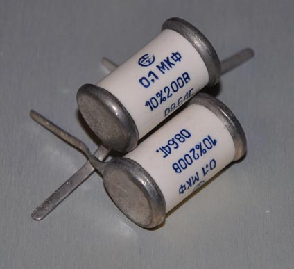

Since we are talking caps;
I replaced C906 with one of these russian NOS PIOs
and C908 with 3n3 Wima FKP2 .
The result was fantastic !
A real big step forward.
I also tried a 0.1u 63V PETP ( K73-16 ) for C906 but didn't like it, sounded a bit harsh, but since i didn't let it burn-in i guess i might try it again.
...and i havent even replaced the oscilator yet, still waiting for the citizen cristal.
This i suspect will add yet more resolution to the sound.
This is indeed a fun project.
A big thank you Peter. 😀
