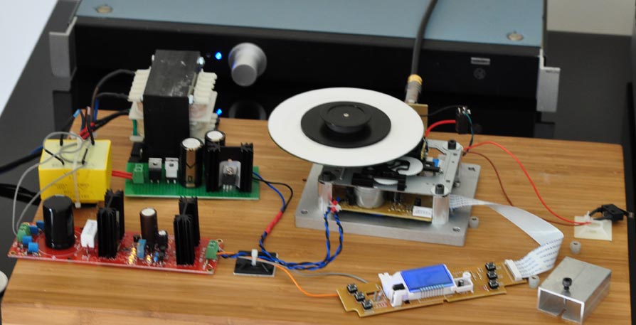

Hi all,
I've been listening and tweaking my "Shigaclone" for some weeks now.
Expectations were high before first try but i was a little disappointed at first listen because i have a very good reference, Shanling 100MKII with all new Rudolf modified IV ( moded by ZM, implemented by yours trully ).
I've replaced transformer, split supplies and made a shunt one for the 5V and all these mods have steadily improved the sound, especially the new 5V supply.
So yesterday i decided to try detaching the electronics from the transport itself, this was easily done and after putting the thing together again i listened for change.
Sound was gorgeous....but drive was skipping ( loosing lock ), this confused me because it played flawlessly before and i made no changes except a longer flat cable.
There is a major improvement in sound...when i can hear it...but the skipping i have no idea what is provoking it.
Any suggestions from the more experienced on this issue will be very appreciated as now i can finally hear, albeit bits at a time, the magic.

Thanks NoSmoking, nemo,
In fact the flat cable might be the culprit because if i touch it while playing ( but no sound...no lock ) it brings sound back in momentarily and looses it again....
Playing with the lazer power pot ...this shortens lazer life doesn't it ?
Or is the pot for focus ?

I wouldn't touch the pot until you change the ribbon.After all , before longer ribbon mod everything was OK so the lens should be in working condition.Try that original short ribbon.You don't have to screw electronic board on the base of the player, just keep it in your hand for diagnostics.This is the simplest way to find out what is the problem.
For protection against eventual static electricity discharge just resolder the protective blob on lower left angle on the lens near the ribbon connector while disconnecting old and connecting new ribbon and then desolder it again.I never fried the lens that comes without the protective blob but since there is protection it is better to use it.

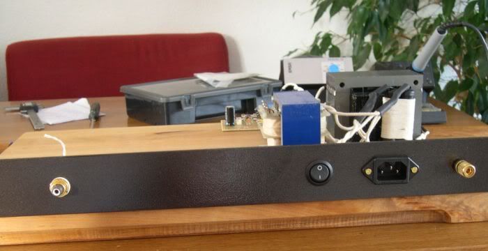

Paintjob finally finished, btw the same colour as my own PiTbull...😀
A lot of wiring going on....

Thanks for the help guys.....
Problem solved.
After putting the thing together again, building a solid chassis for it and putting the original short flat cable in, i still had the skipping problem.
So i made a platter adjustment tool ( same as Peter's ).
Raising the platter about 0,5mm did the job.
The help of the lock indicator was also very useful ( blue led from Buffalo DAC in background ).
So now i can continue tests with longer cable and electronics board away from motors......😎
Problem solved.

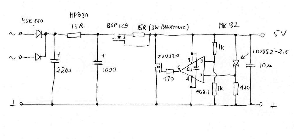

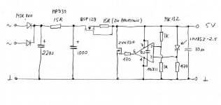

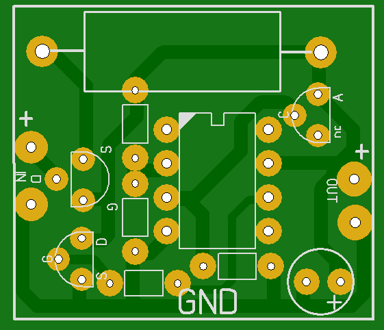

..for those willing to make their own PCBs here is my take for Peter's posted Bobken regulator for the 5V supply.
Please check-it for any mistakes.
I use Bss129 which i managed to source, since Bsp129 was impossible for me.
PCB is 24 X 27 mm and does no include rectifiers and CRC filter, these should be on PSU PCB.
The placing of the output cap is deliberate...it can be placed on it's side if it is too tall to fit in unit.

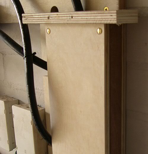

bybee
Since I experienced 3 times the positive influence of implementing Bybee's in the AC for the Shigaclone...it was about time to use it myself in the PiTbull.
I had to find out that the larger ones they DOUBLED in price (all over the world) the last month ....due to the used materials...Yeah sure.!!!!..🙄
Anyway as mailed a few times I heard what they did and as a true audiophile I cannot live without it anymore.....so I paid the costs and bought them, I guess you can say " I'd like to get......" .😱
I have no room left for them inside the PiTbull so I implemented them in the Tunami cable...again a happy marriage that cable with the PiTbull.
Here you can see how I did it..mind you soldering is tricky since the sheath of copper innards of the Tunami cannot stand much heat...
I show you before and after...as if nothing happened..😛
This foto is taken on the other side of the wall (into the workshop) where all the Tunami's come out straight for the fusebox...

Here are final Sprint PCB files for the BOBKEN 5V Reg board.
First of all with my thanks to Peter.
All small resistors are dale CMF50, 3R 3W MOX resistor is panasonic and the PS cap between between pins 4 and 7 of AD811 is soldered directly to these pins on the copper side, inside IC base if you want to use it or directly to IC pins.
BSS129 orientation is correct, drain pin is tweaked to the shown position to optimize PCB.
Hope it proves useful to the forum.
