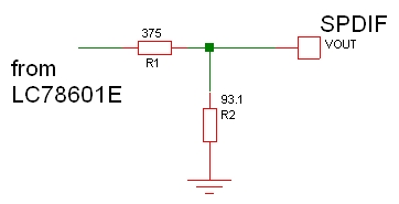

my cd player died 3 months ago.
I decided to build the shigaclone and use a gigaworks converter (small one-Lampucera).
Finished (?) the shigaclone today, hooked it up to the gigaworks (unmodified) DAC and no sound, no hiss etc.
CD's spin I can play, FF RW and stop.
I used the original transformer but made my own PS (8.05V output)
I am putting the shigaclone and the dac inches apart, so didn't use the output resistors.
just a pair of 8 inch wires.
D OUT goes directly to the input of DAC
GRND goes directly to the ground of DAC's input
I didn't use RCA jacks (or F connector).
Paul

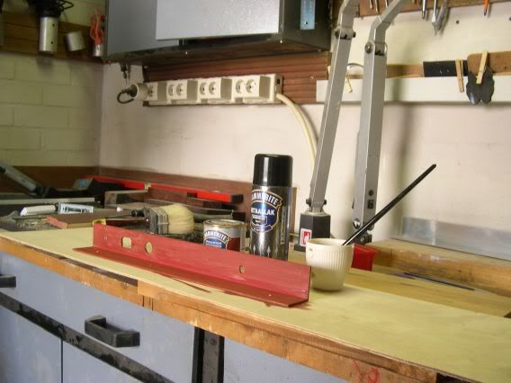

After 2 shoot-outs last week the Mini-PiTbull has proven that it is far superior compared to let us say both visited High-End transports...😎
Reason for me to be very happy and now inspired to give this transport a nice housing in my PiTBull-style, electronically I am finished with it..
The Mini-PiTbull is meant to be for one of those transport owners who now refuses to listen any longer to his High-End player while he can call the Mini-PiTbull his own...😀
In the mean time I will be finishing the other mini-Pitbull but this time with the encasing...
I started with the "connection bar". I do not particularly like the alu (matter of taste) so I start off by giving it 2 alu primer coatings and will spray it black.
This heavy alu bar wil feature a GND, a Furutech Rhodium inlet, an on/off switch and a WBT Nextgen RCA.
