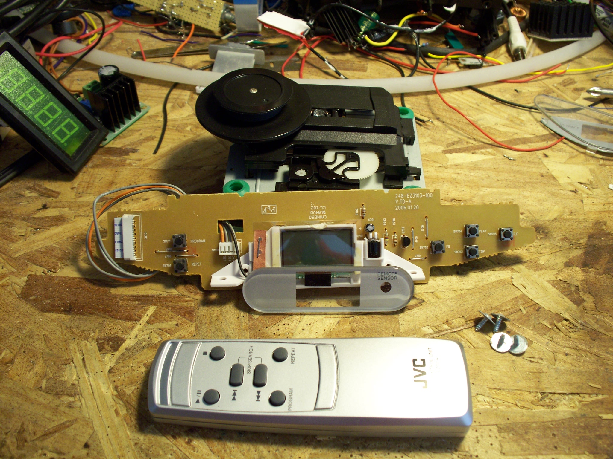

Hi All,
I have been reading from this project for sometimes and decided to give it a try but after a month of sourcing for the JVC RC EZ31/32/51 and not able to find any available in HK. Finally found one JVC RD EZ11 (actuall the only JVC boombox available), bought it and hope it will be similar. I will take it apart and post some picture of the boards and the laser in a day or two. I am a newbe in this area would need all your help.

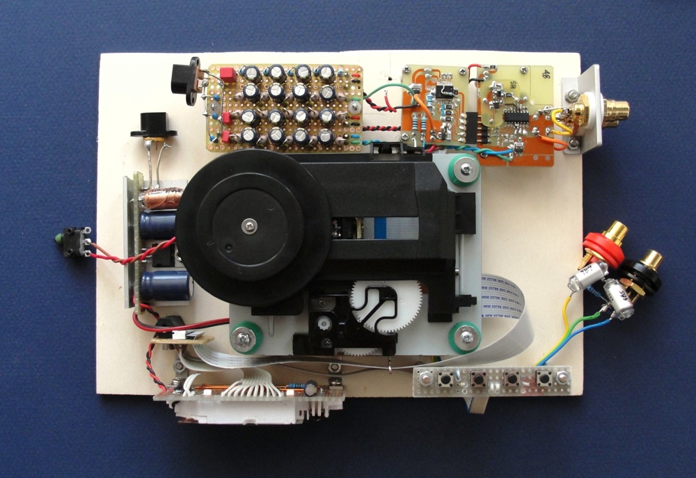

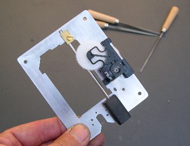

I do not know exactly what you mean so I aswer what I think you mean...😀
On my PiTbull I made my own laserboard out of alu and an rvs laser-guidance rod together with a homemade platform with laser-end-switch etc.
On the Mini-Pitbull I bought a ready assembled laser and motor unit with a laser-end-switch and used a 6 wired plug out of the boombox to connect it (see previuos pics) to the electronic-board.
I use the 8V and 5 V connections on the mini-PiTbull as mentioned in this thread.
Since in my opinion this contraption thrives under a good power supply (which audio component does not🙂) I am heavy on the supplied juices 😀

hi Erik,
Sorry I wasn't clear but line #3ready assembled laser was what I was wanting to know ,I think the boards we ordered have them on them,
How about a pic of the laser rod mod? Did you have to align it afterwards?

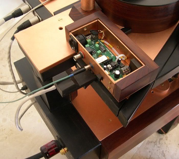

Bybees
Since I heard the Bybees implemented in a Shiga (straight out of the boombox) and implemented on the Mini-PiTbull it was more or less a safe bet to try them out on my own PiTbull....
This time I use the double-barrelled..
Not disapointed...😀
BEFORE
DOUBLE BARRALLED
AFTER
In case you do not spot them Top-Right-Corner of the Digital Out Connectionbox...😉

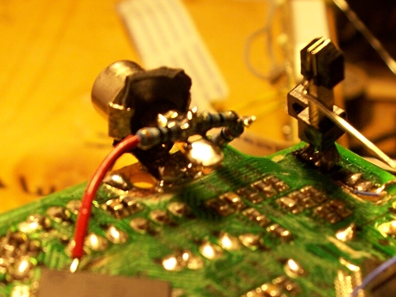

Just a quick fix for the cd switch mine keeps flopping around when I change something on the unit so check out the pic,it's just a left over lead from a cap ,soldered on one side of the switch,then remove the wires and solder on the switch to the board,quick and ez!
Cheers!

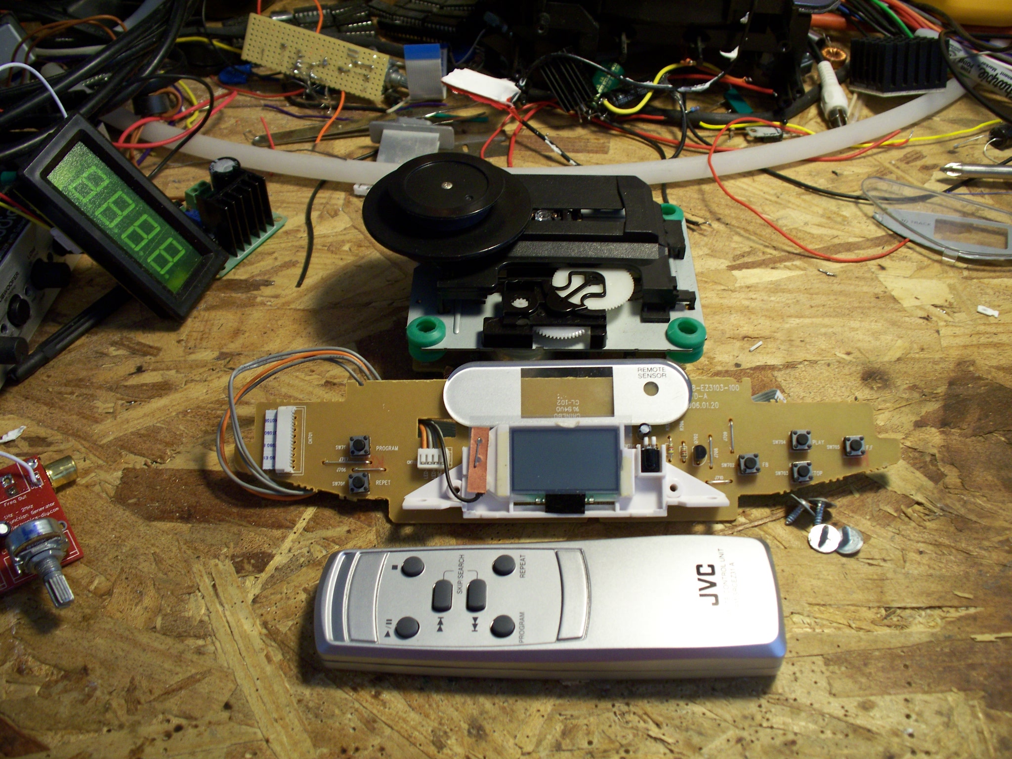

My turn to post a picture.
This is a quick and dirty mock up that I put together yesterday, with the transport connected to my WM8804 / ES90322 modules.
http://www.diyaudio.com/forums/digi...ng-new-ess-vout-dac-es9022-2.html#post2525805
I have to say I am quite please with how it sounds, despite the minimum of effort.
Patrick
