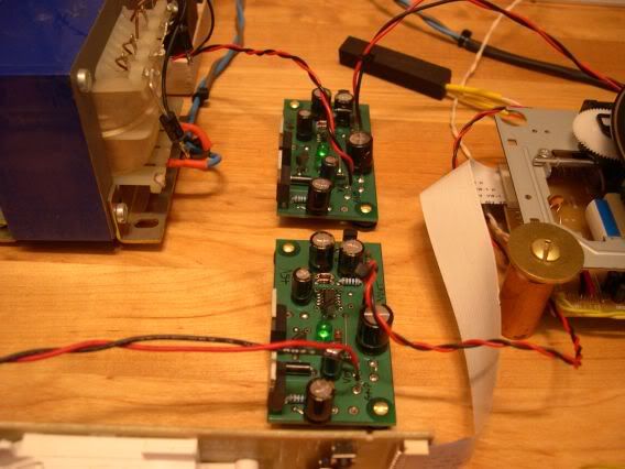

This afternoon a couple of hours hobby-time in order to relax resulted in rigging up 2 super regs for the 5 and 8 V Power Supply.
Immediately it became apparrant (Deja Vu All Over Again) that the piano was so nice soft and silky ("Let No Man Write My Epitaph"....E. Fitzgerald) and with so much more natural grandeur...

Hi Erik,
How did you connect the ALWSR direct behind the diodes?
And "what we all want to know" with or without the secret modifications for the ALWSR 😉

Hi Erik
Any design somewhere for the super regs?
Thanx
Nick
They are ALWSR....If you download its manual you get more design details.
You can buy the parts as well if I am right....
There are a million super regs outthere so do not follow me blindly..
@Rudy I use them the way the manual suggest...and there is a pre regulation before the tracking pre regulation....and no caps afterwards.
Anyway I read you have help with yours so I would stick to that...

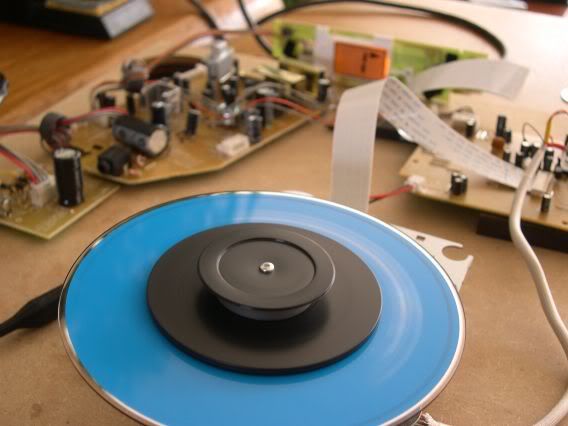

Today I made a detachable platform enabling me to change lasers in seconds (eat your heart out ...to all high end commercial transports
) but much more important getting the electronic board "QUIET"....😉

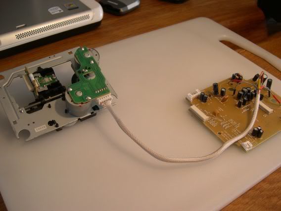

The Mini-PiTbull is becoming better by the week.....driven by my enthusiasm of getting this contraption up to my spec....(I know a touch of arrogance but also sheer fun in (my) belief !!!!)
A feature I experienced in my PiTbull after following a tip from Slawney the German audio-friend ....and I want it to pass it on to my audio friend(s)
A tweak not to be taken lightely...😎
I had Anton (Scrutinizer) to teach me how to do it 😀
If you are observative..there is a 6-pole connector in your boombox which after your own ps you have no further use for....
Order a platform with laser and a leaser-end-switch together with a longer Laser-lint ...attach the 6 wires to your electronic board and be amazed...😱

So you have + and - for the 2 motors, is the remaining pair for the laser sled?
And you still need the ribbon cable, right?

hi,
Thanks!
WOULD you take a pic and show me where are those wires are connected?Today I made a detachable platform enabling me to change lasers in seconds (eat your heart out ...to all high end commercial transports) but much more important getting the electronic board "QUIET"....😉

To aswer both questions 😀
There is a six wires connector on the small print, it's easy to decypher you have the plastic end-switch (open close) with 2 wires...and the two motors with +/- making together the 6 wires.
When you desolder the motors from the old board they are marked with a red dot (+)underneath so that is a quick guide how to mount your wires there .
You still have to use the laser lint, the lenght is up to you.
Make sure you make a rigid construction (shrinktubes) when soldering the 2 wires on the 2 pins of the fragile (old) end switch.
I would not advise to remove the old switch since the connection is underneath the infamous heatsink...😉
I will see tonight if I can photograph something...
