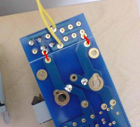

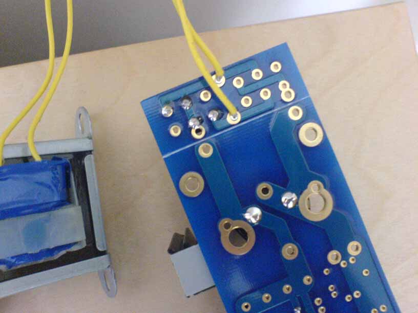

Sorry Peter I'm having an evening of 'brain fog'!!! Would you mind taking a look at my pic of the PSU and indicating where I need to make the joins?
Think I'm getting confused as this transformer has no CT as it's the stock item that came with the JVC.

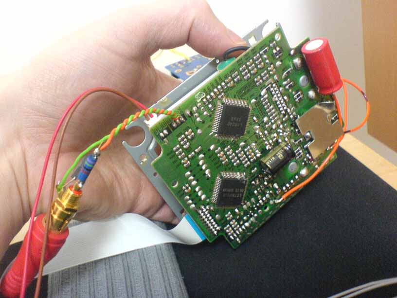

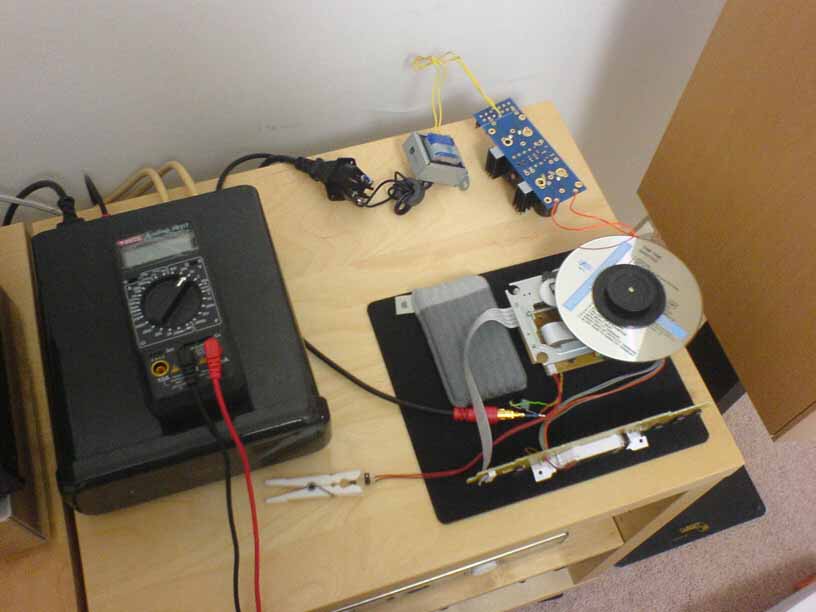

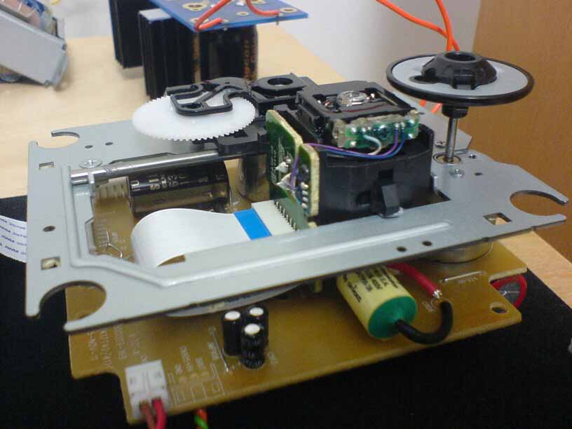

A few pics of my Shigaclone - next adventure will be the chassis 😉
Puffin I used the following items:
Black Gate 1000uF / 50V standard (x 2) for the PSU board (board ordered from Peter). LM7808CT regulator, with two MUR860 diodes.
On the main circuit board I used the following:
C939 (E1) - 100uF / 63V Elna Silmic ARS
C953 (E2) - 330uF / 50V Panasonic FM
C929 (E3) - 4.7uF / 50V Black Gate N
C934 (E4) - 4.7uF / 50V Black Gate N
C916 (E5) - 47uF / 50V Black Gate N
C906 (E6) - 0.1uF 400V Auricap

Puffin, I am using a crystal from an old Yamaha CD player (Marantz & Phillips may be the same) with one board and left the other boards crystal as standard. I think John got his from Peter, or you can get one from DigiKey for £17.43, inc p&p.
I just used Panasonic FC's for the power supply and added some FC's on the board as well.
I think the transport just sound brilliant anyhow..😀
johnm said:Would you mind taking a look at my pic of the PSU and indicating where I need to make the joins?
Here you are
Johnm. Your pics are good. Did you run the transport in standard form and if so how do you rate the mods ?
It looks as though you have been able to ditch the large main board ? (or is it hidden somewhere). If you have, can you explain how, and where you picked the PS supply from to power the spindle etc
What's in the grey sock like thing ?!
Thanks Puffin 🙂
Yes I used the system for a couple of days before I did the mods and I loved the sound. I almost decided to continue without the upgrades... but you know this DIY lark - in for a penny in for a pound (if only it was just a pound!).
If you search this forum for Otapi's PDF it will explain how to wire up the unit with the mods.
I haven't heard it modded yet - ask me again in another 30mins 😉
P.S. The sock thing is my iPod - keeping the transport steady!

Thanks Peter, but shouldn't there be a third link on there? I'm just using two diodes (on the left side of my pic). The red link on the right side dosn't appear to lead anywhere...
With two diodes, you only need red link on the left and the CT from tranformer is connected directly to negative pin of first cap.
This will only work properly wit CT transformer. With single secondary, you need 4 diodes.
Ahaaa right that explains it then - OK so I need two more MUR860s, then connect up as you originally showed, and I assume the white dashes by two of the three holes for each diode position, show where to put the remaining two MUR's?
