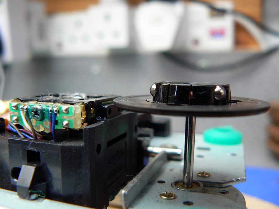

Aw bug*ger! Good on you for trying though. I guess you could alway file away some of the outside circumference until it's clear of the laser sled?

johnm said:Aw bug*ger! Good on you for trying though. I guess you could alway file away some of the outside circumference until it's clear of the laser sled?

The surface of the disk is likely too close to the optical assembly - a malfunction (power failure for example) could cause the optics to hit the disk even if it worked.
