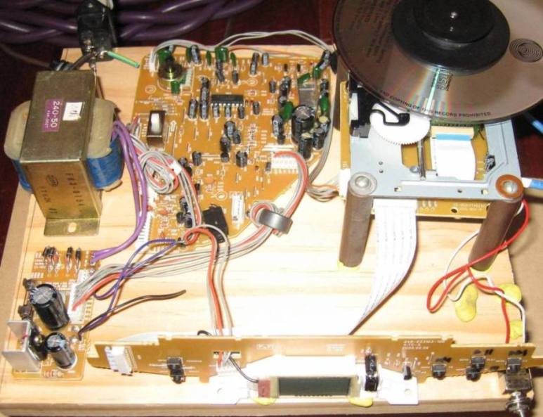

After following this excellent thread for a week and struggling to get in on the act, I finally managed to procure a RCEZ31A. I’m still in the early stages of modding and haven’t built the power supply yet. I’m using the original psu but with a larger 10V transformer.
Johnm, you can use a XF with a single 10V secondary, but you’ll need a 4 diode bridge rectifier, similar to the original psu.
I’ve also found the BYV26C fast, soft recovery diodes to perform very well, better than the Schottky xDQxx series (tried the 11DQ04 and 31DQ04). It’s not easy to get the MUR860 diodes here.
Regarding caps I agree with Oneyedk, the Rybycon ZL & ZA series are great, cheaper than Black Gates and available from RS. I had good success with these caps in Philips swingarm player mods.
As for performance I didn’t think it would match my Philips CDM 2/10 transport which has managed to embarrass several high end units (including CD Pro based ones), but I’m surprised how close the 31A comes in its current state.
The Philips still has the edge detail retrieval, low bass, tone and image placement. But the soundstage and highs initially appear better with the EZ31. I’ll do the cap mods and have another listen on the weekend and report back.

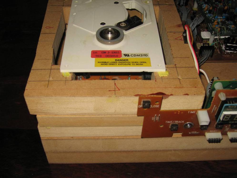

Here is a pic of my Philips CDM 2/10 based transport, it’s still work in progress.
I have used a hard wood & MDF base as I have found that ‘wood is good’ as a mass loaded platform in vibration reduction and it’s also cheaper than brass and copper. A hagclock is just visible in the top right.
It can be a bit temperamental at times. Overall it’s not as good as my beloved CDM1 but better than the CDM 1 Mk II....
Richard
