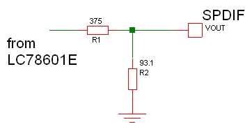

I must say in my tests yesterday I preferred to not have the parallel resistor after the series to ground . Guess why ? becouse the dac has its own 75ohm resistor in parallel at the input . That is at the other side of the cable . After some good listening I am going to choose a value for just series at the output that will vary from a min of 47 ohm to max 100 ohm . Will let you know .
This isn't quite technically correct if you are going to drive a 75 ohm cable, for minimum reflections you need a source impedance of 75 ohms and a termination of 75 ohms. Poor performance using the recommended components is probably an indication of another problem. (bad receiver ic, resistor, cable or connector choices) There is also another issue to consider and that is that most receivers are designed to operate with proper source and load terminations with an input (spdif signal) voltage of around 400 - 500mVpp.. Your approach could deliver as much as 3.5Vpp from a 5V powered source and a potential problem arises if the receiver runs on say 3.3V or less..
Thank you I needed that explanation .
Indeed my receiver ( CS8416 ) is working at 3,3 volts . So I better keep the divider . I also will use the 75 ohm cable .

One other question is I noted the thevenin equivalent source impedance of the spdif out with 75//200 is: 55 ohms - are you using 50 ohm coax? I am planning on using 243 and 110 ohm resistors which results in ~75.8 ohm source impedance for my 75 ohm coax. (Of course I do not have 75 ohm bnc..I keep looking... 😉 ) I'm assuming signal in the range of 3.3Vpp on the processor chip spdif output.
Sorry to quote this old post, but I calculated the resistors again.
Theoretically it should be 375 and 93.75 Ohm.
(you still woulld have to subtract the chips output impedance from the 375 Ohm)
That would give a perfect 75 Ohm output impedance, 1Vpp unloaded and 0.5Vpp loaded with 75 Ohm.
Any other value will render the coax into an antenna or ignore s/pdif specs. (and thus the receiver input)
--> calculation based on 5Vpp processor spdif ouput.
--> If it's 3.3Vpp, it should be 247.48 and 107.6 Ohm (If this is the case, Kevin's values are the best option!)

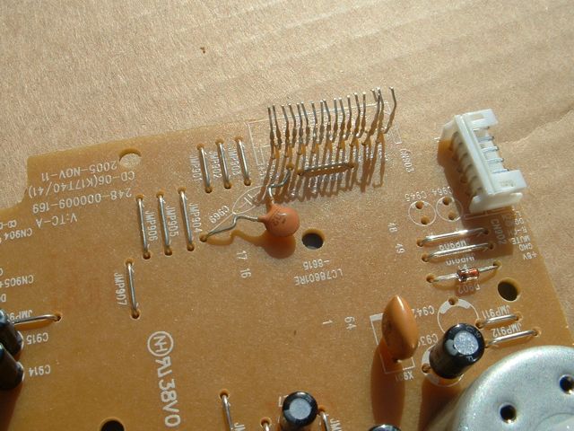

Perhaps a useful tip.....
I removed the display-connector but kept the leads. As I just want to use the remote and perhaps the buttons I wanted to get rid of the flat-cable. You can bend the connector upwards (some force) and cut of the sides, then fold the part without leads of the connector forward by sticking a screwdriver into the connector and twist. As the plastic is hard it will break of easily. Now you have a radiator like piece of plastic with the iron leads. Bend the leads up and again with a screwdriver wick out one by one the plastic strips. See picture for result. It should be easy now to add some wires.... if I can find out again what is pin 1... 😉
That speaking out in terms of scheme is 375 in series at the output followed with a 93,7 in parallel ........ isnt like that ?

Yeps, LC78601E uses 5V so at worst case output would still be 4Vpp (If output current is 12mA).
Chip output will have enough power.
/edit: Kevin, your 3.3V-assumption appears to be wrong.
I'll use a 93.1 Ohm as -what you call- the parallel-resistor and an adjustable 500 Ohm as series resistor. Measurement will show the exact value I need for the series resistor.
1Vpp unloaded output, 0.5Vpp loaded output.
Output impedance is more important than exact output voltage, so I won't worry if I end up with 1.2Vpp unloaded and 0.6Vpp loaded with 75 Ohm.

I guess the 12mA in the datasheet (LC78601E) aren't chosen for nothing.
So a recalculation with 12mA and 4Vpp chip output, gives
R1=291 Ohm and R2=100 Ohm to get 1Vpp unloaded and 0.5Vpp loaded with 75 Ohm.
I'll stick with these values. Kevin came prettty close, even starting from the wrong assumption.
