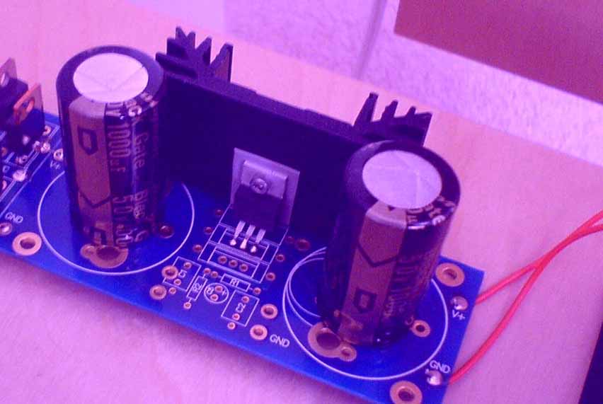

johnm said:Peter, is it OK to use a 16V 48VA 3-amp torroidal transformer (found one in my parts box) with the PSU? I've taken a look at the specs for the LM7808CT and the max input it takes is 34V, so I think I'm ok?
It's not only the voltage, but also the current draw. The regulator runs pretty hot with 12V transformer, with 16V you will need a big heatsink.
Transformer by itself runs pretty warm too, no matter what size.

johnm said:Serious heatsinking? I guess I'd better leave it then which is a shame. Don't think the heatsink I'm using is upto it?
cheers,
- John
I am putting 16,4 volt to the 7808 and much smaller heatsink than that and I dont see all that hotness that is talked about .
So go ahead and try it 🙂
Nothing ventured, nothing gained I guess - will give it a go! 😎
(I'll pray to my audio God first haha!).
