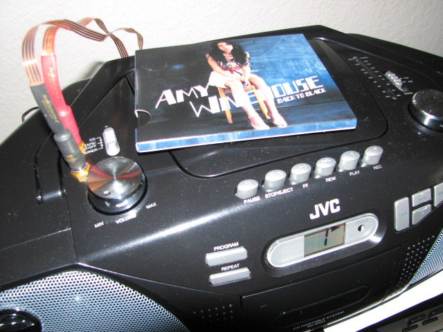

Update: Changed out the stock transformer, for my 16V 46VA torroidal one. Seems to be running fine. The heatsink is very warm, but it seems stable. I believe the LM4808 has protection circuitry at any rate, just in case. However it's been running for over an hour constantly and seems fine.
Too early to tell any obvious advantages over the original as yet...

Well my latest victim (another RCEZ32) just arrived, I'll be picking it up at the post office.
I'll make all the mods to the controller board and mount everything on the chassis plate over the next few days. I was very happy with the performance - had not finished tweaking, but the installation of BG in selected locations was definitely helping. I have not messed with the tracking servo cap yet. Caps are located in different places on this board.
I will publish my implementation information once I am sure I have something that can be replicated.
