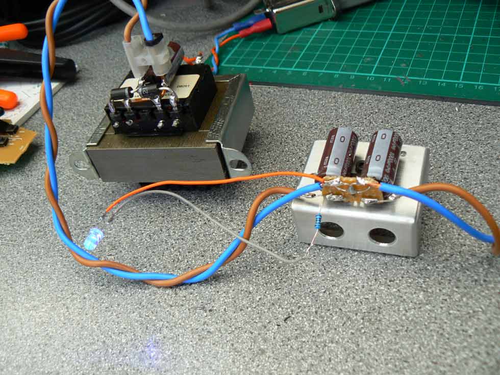

My transformer arrived this morning. Just to make sure I have this right... it's got two secondaries, both 0v - 12v. Do I connect the two 'inner' windings together, and this is my CT which goes to the negative rail. And the two 'outer' tags (0 and 12v) both goto the AC in section?
- John
Hi John,
I think you're right. Just to be clear, in the diagram here :
http://www.airlinktransformers.com/technical-fitting.asp?data=4
the black and yellow wires are tied together to form the CT.

I think I need to take a crash course in how transformers work. Still confused. When I tried out my 16v transformer Peter said it might be too much for the LM7808 regulator, unless I used a LARGE heatsink.
However, using this transformer 2 x 12v (a recommended configuration for this project), surely the regulator will have to then deal with 24 volts then? Or have I got this all wrong?
Johnm. If you have 2 pairs of secondary's,you can join the two inner wires to make a CT,but I beleive that you will get 24v on the two outer wires. Check it with a meter.
If all you need is 12v ac just use one pair of the secondary's

Johnm. The photo below shows a dual secondary tranny. One pair of the ac sec's is connected to one bridge and the other set of ac secondary's to the other bridge. The Bridge Rects are marked + & -, these are the dc outs. the terminals in the opppsite corners are connected together to provide the 0v voltage ref
http://i73.photobucket.com/albums/i239/saxonsex/DualBRect.jpg
In the second picture I use a CT tapped tranny and only one Br Rect. This is simpler in that the two dc outs are marked +& - and the ac goes to the other two. The CT is connected to direct to the power ground.
http://i73.photobucket.com/albums/i239/saxonsex/SingleBridgeRect.jpg

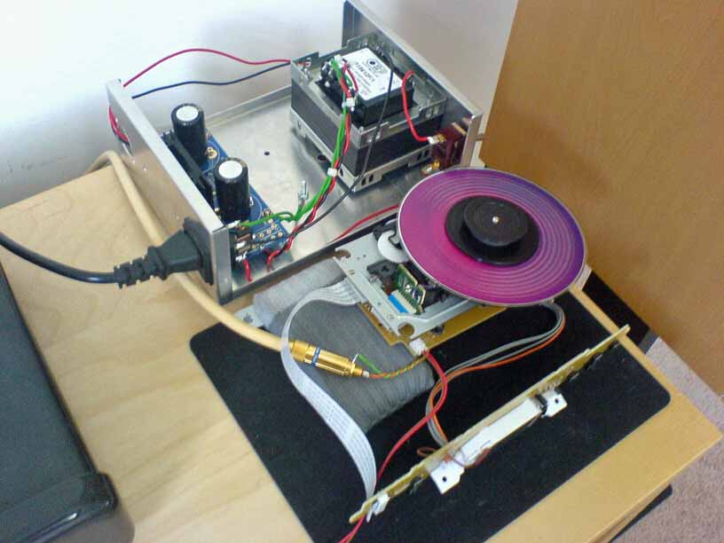

Hi got mine up and running today -will allow burning in-unable to get GB from OZ and M Percy is not responding
So far upgrade power supply with full bridge rectifier-Mundorf power cap
all caps are replaced with Rubycon ZA/ZL/ZLG series
dig out-75R/75R
So far so good.

I'm clear now - I'll twist together the two wires in the 'center' for the CT, and - as Peter said - this will go directly to the negative of the first PSU cap.
The 'outer' 0v and 12v on the transformer will goto both AC points on Peter's PSU board.
I will be using the PSU board with only two diodes as shown in earlier pics.
Thanks,
- John
P.S. Just to avid confusion, both the JVC and the 16v torroidal I used were both single secondaries only, and for those I used four diodes. For this new dual secondary (2 x 12V) transformer I just use two - correct?
johnm said:
Thanks Puffin / Kevin 🙂
That's right. With the centre tap configuration, only two
diodes are require.
Dennis

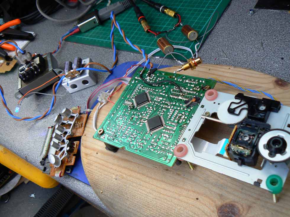

Directions for use with RCEZ32 Only!
The picture above shows which parts and connectors to remove from the micro-controller board.
This picture shows where to make the connections to the micro-controller pcb. Be extremely careful as any mistakes may result in a RUINED micro-controller. The micro-processor on this board is a mask programmed part which was available to OEM users only, and is now discontinued.
Note the red wire in the foreground left this is 12V_SW, directly behind is the red/black wire which is power control.
This picture shows the location of the wire used to power the led. Cut jumper on other side of the pcb at this location.
Please ring out and verify connections using audio board and psu before making modifications. Be extremely careful, I cannot be held responsible for mis-wiring or mistakes in these directions. (I've tried to make them as clear as possible.) Use at your own risk!
