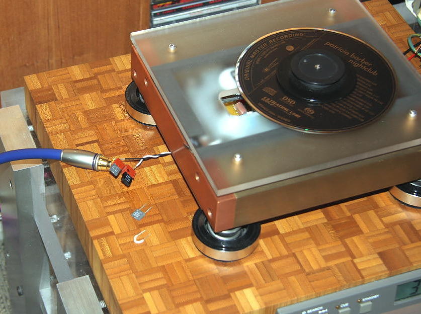

Hi Johnm,
Up until now I have mainly focused so far on getting the micro-controller board issues sorted out, and now that I have completed that I can proceed to the next phase and that is evaluating what if any further changes I can/should make to the mechanism and board.
So far I have changed the resonator to the Citizen Crystal Peter recommended which I thought made for a very noticeable improvement. The stock resonator made things sound a bit grainy to put it nicely.. 😀 This was done in isolation to any other changes - it was the first thing I did IIRC.
I also have removed the common mode choke and replaced a few capacitors here and there. One of these is the supply bypass for the dsp chip LC78629, and the others are used to determine various tc in the ASP (LA9241). I did notice some improvement with the replacement of these various caps. I have not replaced the tracking servo tc cap which in my unit appears to be 0.33uF - some experimentation is warranted here. I need to identify the analogs to the other caps changed in the RCEZ31, but I am probably on my own here. I do have all of the required data sheets so this should help.
Due to the fact that I am using an outboard micro-controller the PSU got rather elaborate compared to what is required for the RCEZ31 version, due to space constraints I elected to go with a single bridge (individual high speed Schottky rectifiers) and a single low ESR cap. It is possible that further improvement is possible with a separate supply for the mechanism as long as it remains under the control of the uP power control circuit. I will report that there was a pretty substantial reduction in noise and ground bounce visible on the spdif output after changing to this supply.
In terms of the sonics I can't compare to the RCEZ31 based version - not having heard that, that said I suspect they are quite similar given the similar construction and related chipset.
Cold it is not very impressive, sounds about like you would expect for about $5 worth of electronics and mechanism, and lest you think I exaggerate bear in mind what the assembled boom box costs with all profits and shipping/warehousing expense added.
As it warms up the sound seems to evolve, it always retains a certain polite understatement, but the sound blooms, by this I mean the sound stage opens up, depth and width increase greatly, you become aware of the fact that you are hearing a surprising level of background detail, highs are clean and very extended, and the music has a nice flow to it. Bass is very good even when cold. On really well recorded CDs there is an almost analog like quality to the sound.

I spent about an hour or so listening to it this morning, have to say that while it does a lot of things right there is a certain mechanical quality to the sound that never quite goes away.. Could be nothing more than the break in of the few BG caps I have so far installed, or it could be an indication that more work is required.
I do plan to add a considerable amount of additional mass on either side of the mechanism. This will either be aluminum or brass bar stock - basically whatever I can get my hands on.
One thing I can say is it is working quite predictably, no odd quirks at all.
Now it is just a matter of finding the level of refinement I seek.

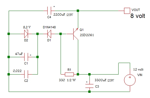

The stock unit is quite similar PS , you can use it . You just need to turn on the 8volt regulator maually by putting a short on the board . The bridge has capacitors across each diode .

1) outpboard supply: check different transformer types and power rating, diode types and bridge configurations
2) the regulator type, most likely LM7808 is a proven choice, but experiment with caps before and after regulator.

The EZ32 has a 7808 regulator on it, so will work for now while I work on Kevin's mods to get rid of the audio board. Waiting for some of those $3 25VCT transformers from Parts Express to arrive while laying out a new board.
Took the small 3 pin header off the corner of the audio board and put it in the holes where the DOUT is located on this unit, so I can play with the SPDIF loading without having to touch the board, but it sounds nice for now with 390/100 ohms, feeding one of Peter's NOS DAC's.
Now the real fun begins.
Thanks to all for help in this thread.
Craig
Craig
RCEZ32 Clone Update
Happy to report that removing the ferrite on the ac power leads to the stock transformer effected a pretty big improvement. The mechanical sound quality I complained about in my last post is mostly gone.
I tried several other EI transformers and noted no particular sonic advantage while listening so I stuck the stock transformer back in my transport. It fits and some of the bigger ones really do not.
Finally I added a couple of small 33uF/63V Nichicon VZ series caps at the output of the 8V supply. I noted some improvement in the smoothness of the highs, and a slight improvement in overall imaging. I did not use BG caps in my supplies so I cannot indicate whether or not this would result in an improvement or not.
I am now also able to use the remote control.
For whatever reason this thing certainly is revealing, far better in some respects perhaps than any cd player I have owned to this point. I am sometimes amazed at what it does for multi-track vocals, it resolves rather well.
