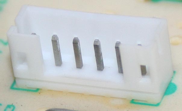

Romy's talking about modding CEC TL0, not Levinson, and it appears that TL0 uses very similar crystal to the Citizen I've been sugesting for Shigaclones, see attached pic.
The Citizen crystal is OK but it takes more making a low jitter oscillator.

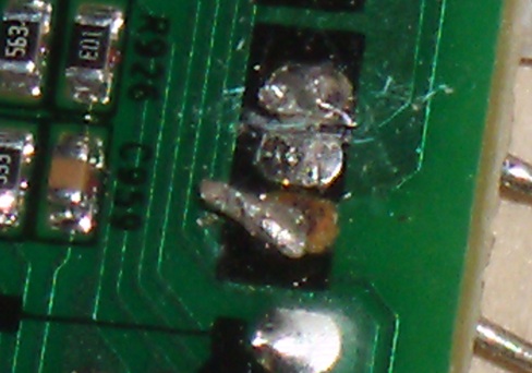

I joined the forum some time ago because of this thread. With some difficulty, I managed to find a RC-EZ51. Until it is all sorted with power supplies and maybe some other mods it is mounted in some 18mm multiplex. The plan is to use separate power supplies of the board and the two motors, and maybe later add a Trichord clock with its own power supply.
Unfortunately, it seems I have already destroyed the digital out and therefore my project. I had mounted a pair of resistors of less-than-ideal values, and had not connected the shield of the 75 Ohm coax cable to the dac. While connecting the shield I swapped resistors for a 300/100 Ohm pair, and the solder pad for the digital output just let go. I have no experience with this kind of soldering, and probably overheated it.
Can anybody tell me if / how I can still get a digital output?
You can get the signal from the IC (LC78601 pin29) or the track from the IC to the pad, but it's not an easy task. Are you sure the output pads cannot be repaired? Maybe you can remove the soldering with a desoldering sucker and use the pads again. Please post a photo.
If the pad still exists - just take a piece of bare wire, thread the pad, wrap around the PCB edge, twist fast and solder the pad, done.

But back to the subject. All that is left of the pad is bare PCB. There is a very small chance that it is repairable though: I noticed a tiny spot of solder on the rear edge of were the pad used to be, right at were the PCB-track starts. So if I retract the resistor lead while heating it, the remaining solder might just flow and form a new pad.
However, I noticed that solder by itself does not really stick to a PCB. Can anyone tell me whether they glue the pads on, or is it really just a question of letting the solder flow at the right temperature?

No, you will need to scrape a little of the solder mask of off the end of the trace where you see the solder blob, and very carefully solder a small piece of kynar 30ga wirewrap wire to that trace. You can form a loop to replace the missing pad or just bring it directly through the existing hole. Once you are sure it is working ok secure it with a little super glue.
Do not solder the resistors directly to these pads, 30yrs of experience and I made the same exact mistake. (I'm fortunate to have several boards - so the one I damaged is now a back up.) Instead use short flexible wire (an inch or so will do) from the two board connections and solder the resistor pair to those. The boards are made of bottom of the barrel phenolic (paper based) and the traces are 1oz copper or less and the adhesive used to secure them is not that strong either.
Thanks for the great advice! I am practicing on the tuner PCB: removing the top layer to get at the traces (more difficult than I thought, usually I scratch straight through the trace as well), soldering on traces and solderpads to find the limits, etcetera.

PS: here's a pic of the problem.

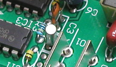

it's a standart problem. use a male plug. solder it sraight in position. Your's pad's will be safe. photo below shows the type of the nest. use 3 pin nest.
big drop of solder should keep this nest in proper position.
<snip>.
This is actually what I have done on both the damaged and undamaged pcb I have on hand. Works like a charm.. You may have a suitable connector that can be removed from one of the other boards.
