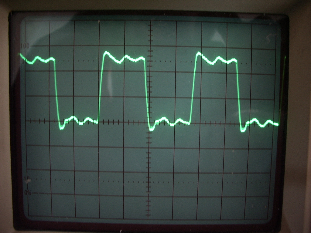

I tried the reclocking scheme you posted at #3786 but I got very messy dout signal. See pictures below: first dout from the board (pin 29 LC78601) with reclocking circuit not connected, second the same with reclocking circuit connected, third dout from the reclocking circuit.
Unfortunately I wasn't able to listen music through the reclocking cause for unknown (at least to me) reason, the remote control stop working and digits on LCD screen disappear when the reclocking circuit is connected. I tried many times with reclocking circuit on and off, but the same rule. It would be very interesting from a listening point of view to see if there's a difference between these two very different signals.
I'll try to build again the reclocking circuit from scratch to see if I get the same results.

The reclocked signal is a lot lower than the others isn't it? Is this before or after the 300/100 resistors?

Yes it is, about 50%.
Before resistors.
These are the signals after output resistors.
First pic is with reclocking circuit not connected (I'm sorry I lost 200ns pic)

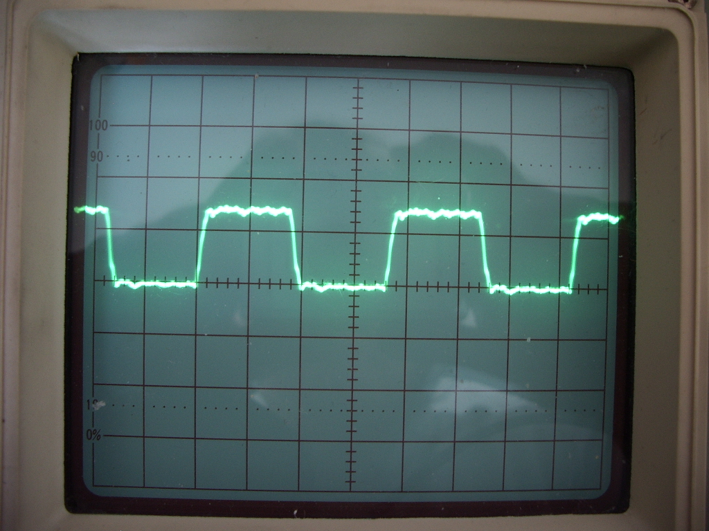

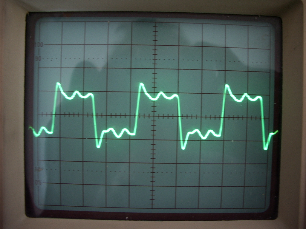

Reclocking traces
Ok - here are the traces from my Shiga - from the left.........
1. the Dout straight from the board (2V/200nS)
2. the output from the re-clocking cct (before R divider - 2V/200nS)
3. the final output after 300/100R divider (0.5V/200nS) the resistors seem to have cleaned up the pulse really well too - both are Kiwame 1W jobs. I notice the level is a little low mind - only about 0.7Vpp.
the 0V horizontal is centre on all traces - I noticed that because of the 0.1uF cap on the re-clocker o/p the final output is centred about 0V rather than being a purely positive going pulse - wasn't sure that this should be so - 😕 maybe someone does - Peter?
anyway I removed the 0.1u and took the output straight from pin 9 of the flip-flop - this is trace 4 - it is now a purely positive going pulse, again at 0.5V/200nS. A quick listen and it doesn't seem to have affected the sound - I think my Caiman has a 'pulse shaper' buffer type thing on the input anyway so it is probably taken care of there.
One thing i did notice Peter - if I take the MCLK back to the main board after 3 invertors (pin 6) then I still get the occasional skip and distortion - but if I just use 2 invertors (pin 4) or 1 invertor (pin 2) then it will work just fine - I've listened to it now using either 1 or 2 invertors for several hours and it's stable. Any ideas why this might be happening? Why did you suggest 3 invertors on the original cct? - was it a timing issue ? - sorry for all the questions - I'm hoping to learn something here! 🙂

Would be more interesting to watch the trace at the DAC side - that side is important one not the shiga side. I've found that tuning the shiga out and DAC in impedances (simultaneously - by changing resistors) is crucial, and what's mostly interesting: what you see at DAC side reflects very much what you hear 🙂
