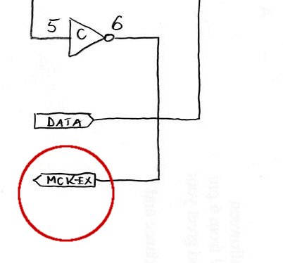

back on the subject of power supplies - a couple of weeks ago i finally decided to split the +5v supply at the point in the pic below which is from a previous post - hope the owner doesn't mind me using it.
I'm aware that many peoples experience is that it makes no difference but I've almost always found that seperating supplies like this makes a great difference to sound quality - anyway, i had to give it a go to satisfy my own curiosity.
i injected a fresh +5v supply from an Audiocom Super Reg 3 which i acquired recently. I also replaced C954 with a decent 10uF BG (it is actually across the +5v supply) and sat back ................................. I have to say that while there was an improvement in clarity - it also seemed to muddy the waters a bit in the lower freqs! - not good.
I then decided to try one of these instead - MURATA POWER SOLUTIONS|7805SR-C|SWITCHING REGULATOR | Farnell United Kingdom
I found out about these babies from AoS and was pretty impressed by them - in it went and I sat back again ...................................... much much better!! - the same clarity but without muddying up the bass - very happy - and cheap too!
Certainly I reckon it is worth seperating that +5v supply - but the results do seem to be dependant on the reg used.

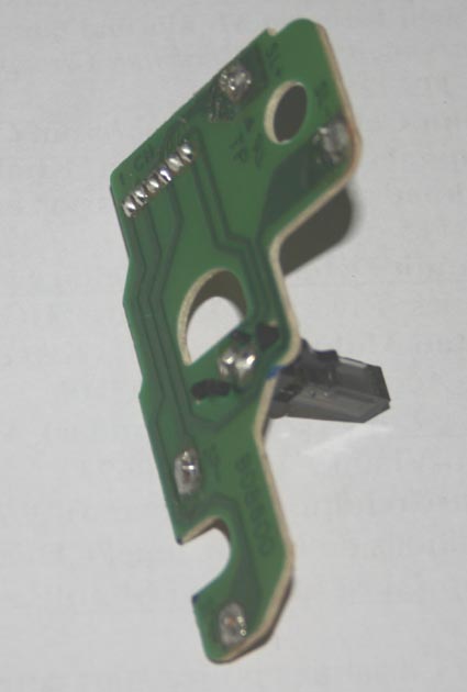

When I bought a spare mechanism, it came with a small pcb just containing an end of travel limit switch and a connection socket.
I took mine off and replaced it with the main standard board and forgot about it. Then I saw somewhere an image of the main board separated from the mechanism and strung out like a trampoline to one side.
I did not see any comments as to whether this has any positive effects, (replacing the main board by a much lighter one - not the trampoline) but seen as how the shigaclone is so sensitive to mechanical mounting I would not be surprised.
Anybody like to comment? I am too lazy to take it all apart and remount it just to try.

The advice given waaaay back in the thread was that it was beneficial to separate the PCB from the mech. In my case one is jut mounted above the other and I added a little bit of wire to "extend" the reach of the bit of plastic on the mech that hits the limit switch.
I think the theory was that you were removing the motors from the pcb and they were a contributor to noise and vibration. Does it make a big difference? Probably not huge, but its all incremental I suppose. I don't think Peter does it anymore.

I was never separating motors from main board; too much hassle. Besides, I do have "backup" transport with such feature 😉

Yes, I think it is worth separating electronics from mech for better details and opportunity to tune the sound by placing the el. board on various supports(carbon rods,wood etc.).The best in my chain it sounded with carbon placed on parafin table.Try it ,just have to solder 6 wires from board to board.Much better this way in my case.With Shiga you can tune the sound in so many ways ,what is the best part of the project.It remind my to analog turntable time ,endless bettering. By the way ,how to easy upload the photos with the post(always too big the photo size).
