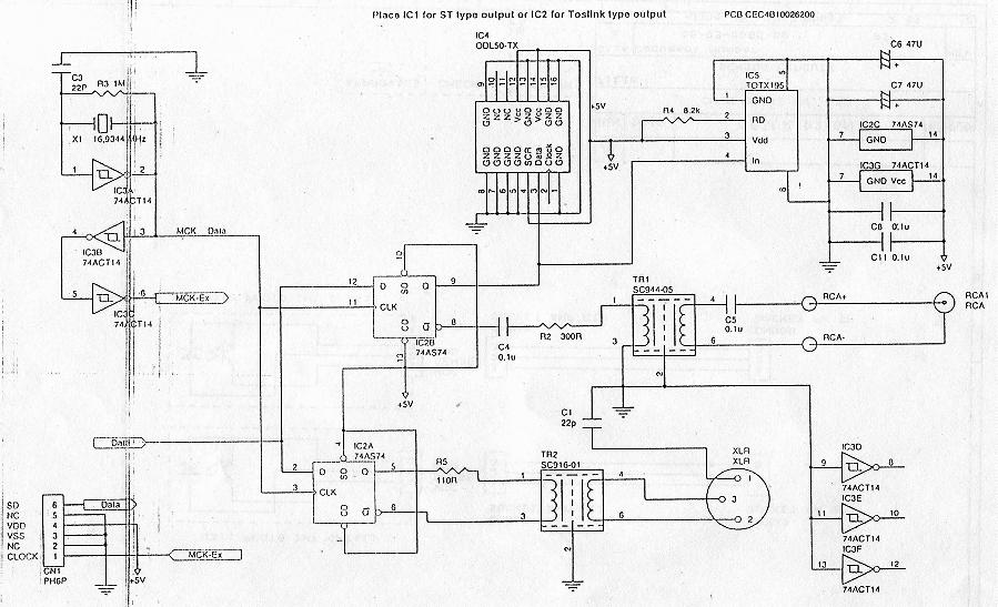

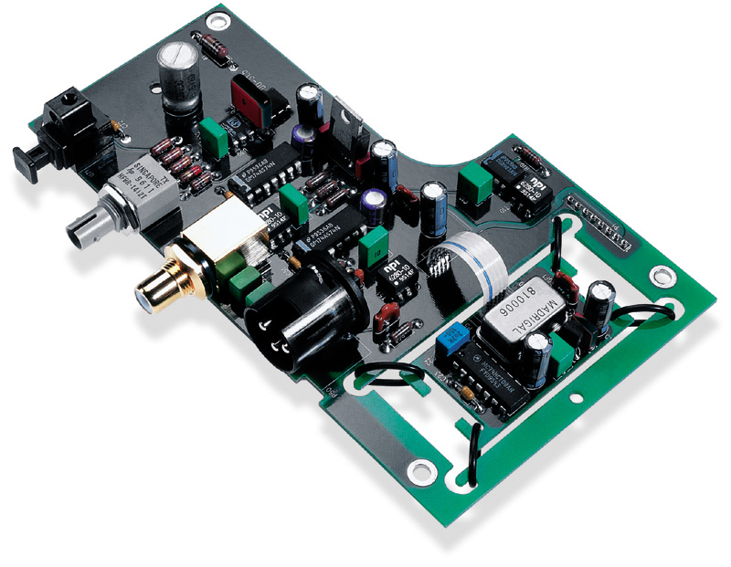

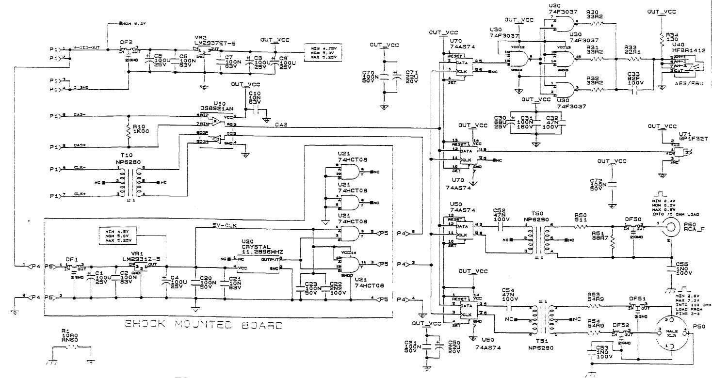

Attached is original CEC TL0 clocked output schematic and pics of the boards. "The master oscillator (a crystal which looks like Citizen) controls not the transport mechanism but the output stage, a flip-flop chip that could be considered a 1-bit FIFO. The output data thus have the maximum timing precision, which is where it is needed. The mechanical drive is slaved to the output stage".

And this how I did it in my transport. Please see attached edited CEC schematic (according to board layout the RCA output is actually taken from pin 9 of the flip-flop)

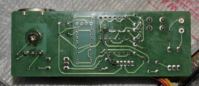

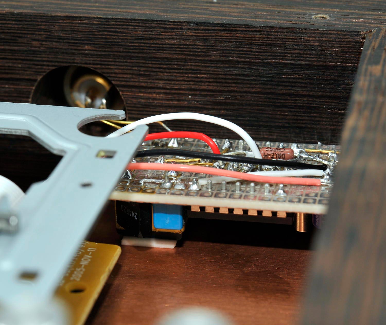

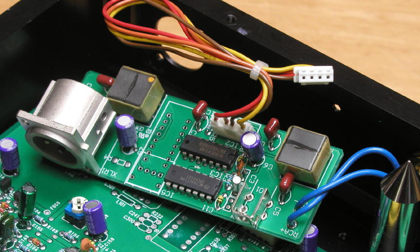

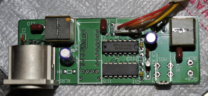

I added a small board with two chips and few additional parts (used exactly same chips as CEC, some experimenting here with different types maybe worthwhile and will follow), crystal is Citizen and output transformer Scientific Conversion. I didn't use output coupling cap, it's not really needed here as long the DAC does not show any input DC offset.
I didn't use any additional regulator (TL0 does not use one either) the power, data and ground are simply taken from main board, another wire connects clock signal from output board to main board (use resonator pad which is further away from LC78601 chip)
How does it sound? Well, I didn't find anything wrong with the transport in a first place, with a mod though, it has a bit less of edginess and thin sounding, which some people may find sort of annoying. It produces sounds that are better defined in space and possibly more refined. It's certainly worth trying and I would be interested how others find it.

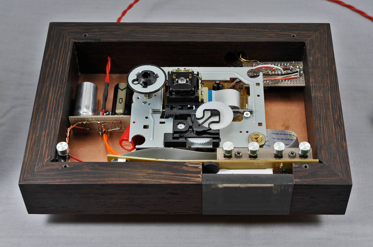

popping noise!!!! need help
hi guys!!!
ive completed my build yesterday and really it sounds great!!! thanks for all your help!!!
the problem is im hearing occasional popping noises. theres a popping noise every time i press play and occasionally during heavy music transients/passages.
im using panasonic tsha caps in PS. and instead of Peter's recommendation on C916 of 47uf or 33uf, im using 30uf motor run as this is my only available cap for the moment.
is this 30uf cap insufficient?
anybody else has had the same problem?
my setup is: shigaclone connected to behringer upsampler then to cs4397 dac.
i have no problem when i use different transport.
thanks guys

problem solved!!!! i just replaced the motor run cap in C916 with 47uf.
no more popping noise!!!!😛
good thing parts ordered arrived today!!!! im so satisfied with the sound quality.
