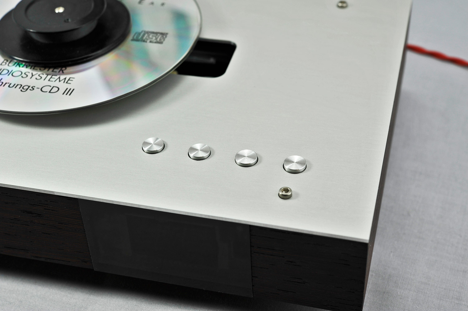

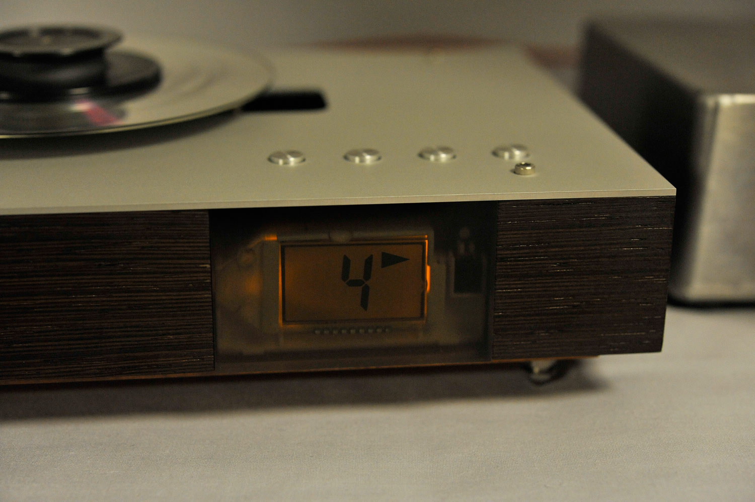

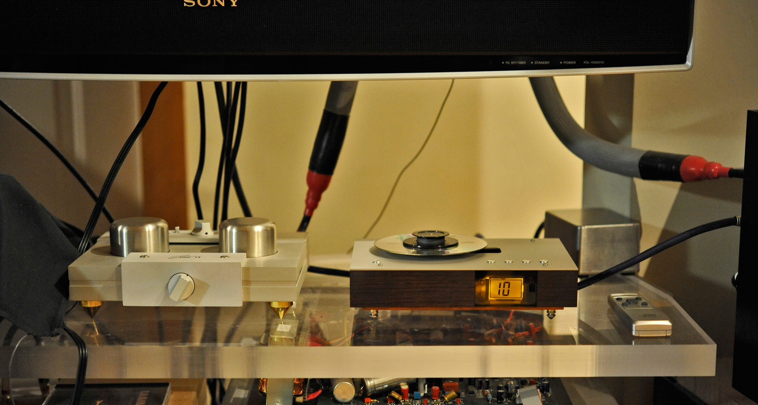

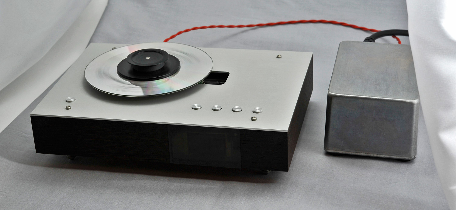

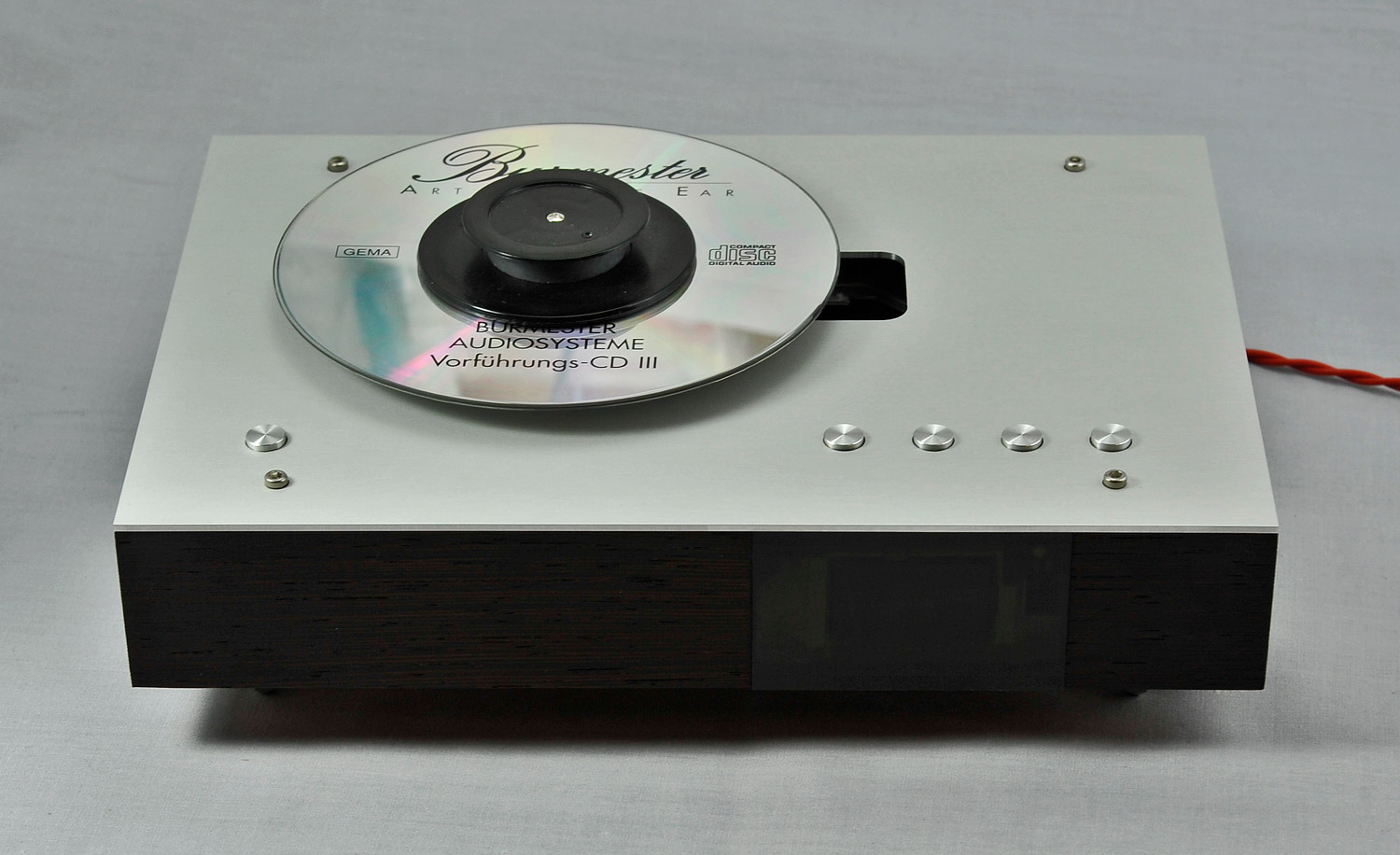

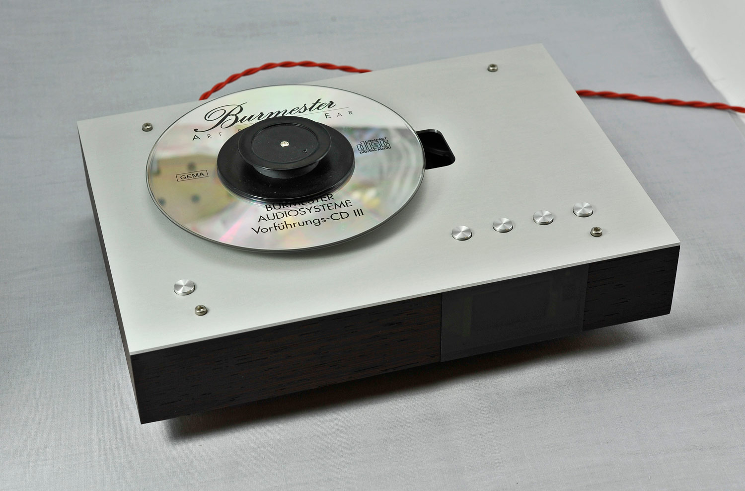

I just finalized most recent incarnation of the transport. This time, instead of frosted acrylic I used 1/8" aluminum top, which gives slimmer profile. With small aluminum buttons and dark window the looks are clean and simple and I like that Spartan appearance. So far it's my favorite.
The display cover is simply a piece of 3/8 tinted acrylic with backside brushed except for display window. I used similar technique in this project: http://www.diyaudio.com/forums/soli...-mark-levinson-38-preamp-chassis-scratch.html
The rest of the build was described here: http://www.diyaudio.com/forums/digi...ansport-shigaclone-story-118.html#post1669753

Beautiful work as always Peter!
What's the wood - looks like too much grain for ebony, zebrano maybe?
Good test cd too!

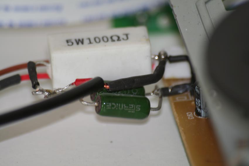

As a newcomer to this hobby one of the most difficult things I am facing is choosing the right substitute product if I cannot put my hands on that which is recommended. I just don't have the experience. Capacitors are a big problem. What type of capacitor to use where - is the first question and the second is the supplier/model to choose. Until starting this project I did not even realise that there are similar problems with resistors, but apparantly there are.
What I have done on this project to get going is as follows:
For the power supply, I had a spare 13.8v regulated power supply so fed that through an LM7808 using a Panasonic FC 1000uF 35v on the input side and a panasonic FC 1000uF 25v on the output side.
I replaced C916 by an Elna RFS 47uF 25v and removed the bypass caps.
For A1 and A2 output resistors I used what I had available, i.e. two 600 ohm Sfernice's in parallel for the 300ohm and what I believe is a 5w wire-wound for the 100ohm (see pic).
This all gives me a pretty good sound but I have not mounted everything onto a solid base yet.
Any advice on my set-up would be most welcome.

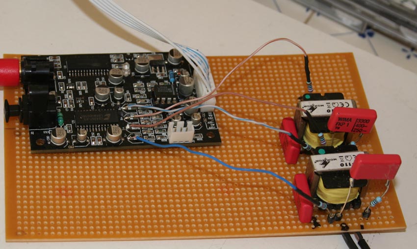

In parallel with this Shigaclone project, I bought a small DAC from Hong Kong and modified it according to the "Experience with this DIY DAC" thread on this forum. I then bumped into the same problems of capacitor and resistor choice when hooking up the output transformers. The picture below shows what I did. It works but I don't know if I could do a lot better with different components. I should be posting this message on the other thread, I know, but I have a suspicion that a few of us are going down this same route and there may be matching implications to be considered when coupling the DAC to the Shigaclone.
Just for information, and not trying to overcomplicate things, I am putting the DAC output through a Lightspeed attenuator into a MyRef amp also made following other threads on this forum. My speakers are full range Audio Nirvana 10inch. I am overall pleased with the results but feel that the highs are sometimes too harsh, and who knows, maybe things could be a lot better with a bit of fine tuning.
Thanks for the offer to purchase through your Digikey account but before taking you up on that I would like to see what reactions I get to the above. It all adds to the learning curve.

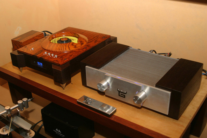

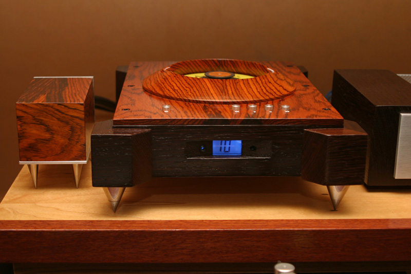

Love your new design. Love to use wenge too. I recently finished my second transport, inspired by your creations.
Cocobolo top, wenge sides, 1/2" thick sheet of aluminum bottom. DIY remote to match. This CDT is mechanically a lot quieter than the first one I made.
