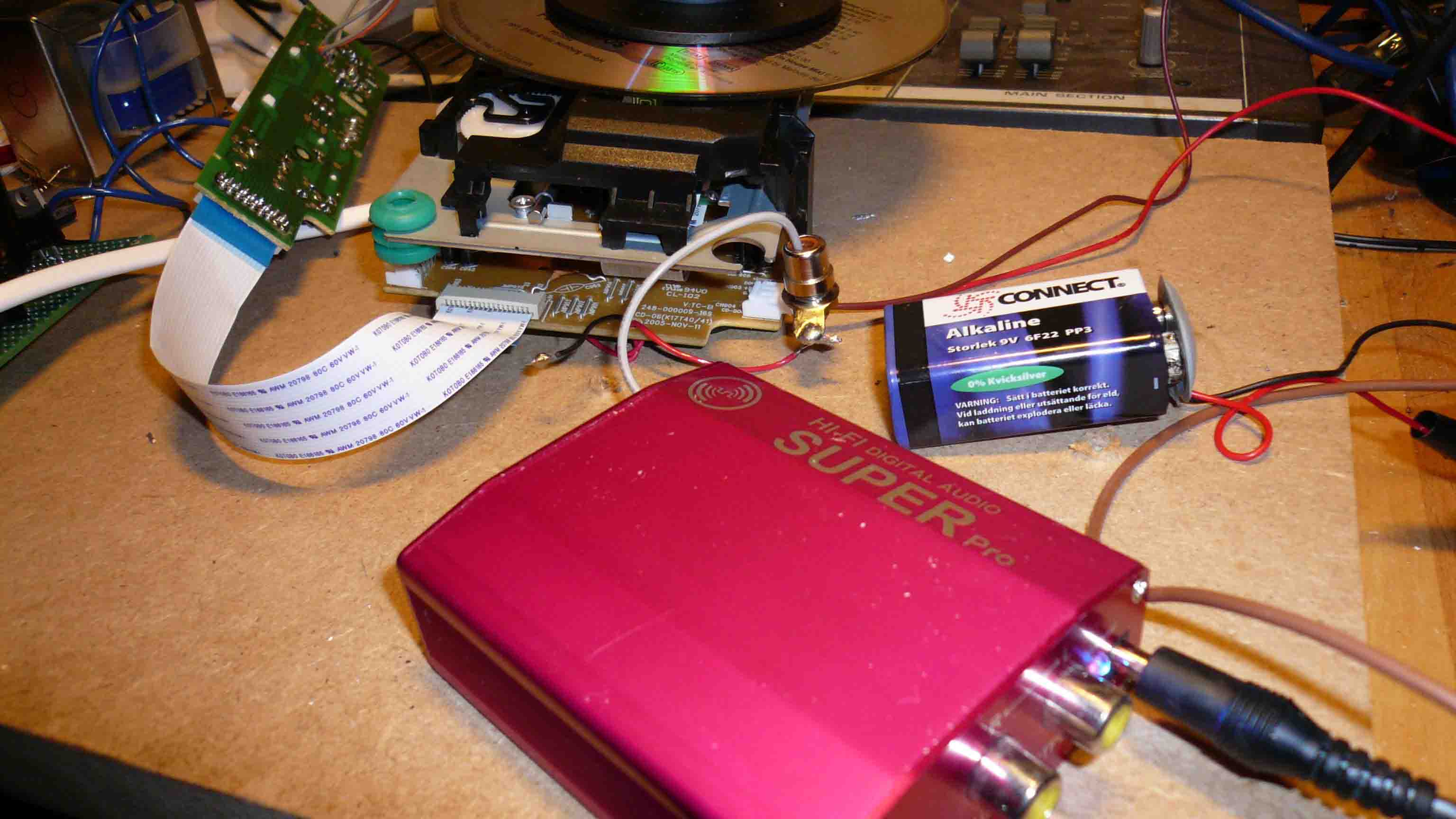

I have just bought an demo ez51 cheap and fired it up,just digital out.
But i have an crackling sound coming out and it doesnt matter what resistors i choose.
I have tried my Quatafire external sound card the Super Pro box.
Just crackling.
But if i connect it to Behringer DCX2496 it works and i have very high output.
The input sliders at almost zero.
So its very high output from the player,but i cant tame it and get rid of the crackles that
come one second and disappear next and come back.
Any suggestions?
I experienced similar symptoms when my ground connection for the digital output came unconnected. check your ground.

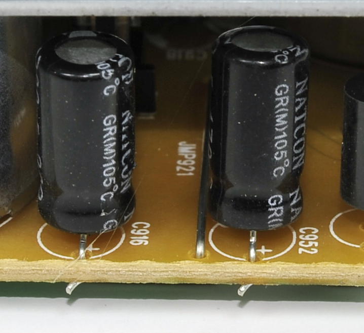

Is C952 the R5 and C916 the E5 on the pdf? if not what is it? where are the ceramic bypasses of C952 and C916 in the pdf?
BG will be probably better, but if you can't find them, use whatever else that works. Silmics have good opinion and are certainly worth a try.

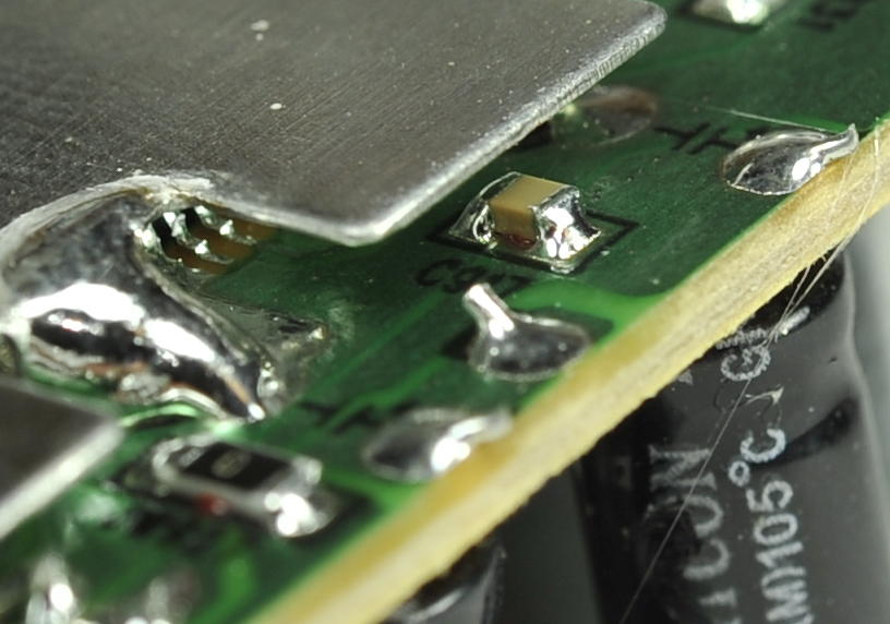

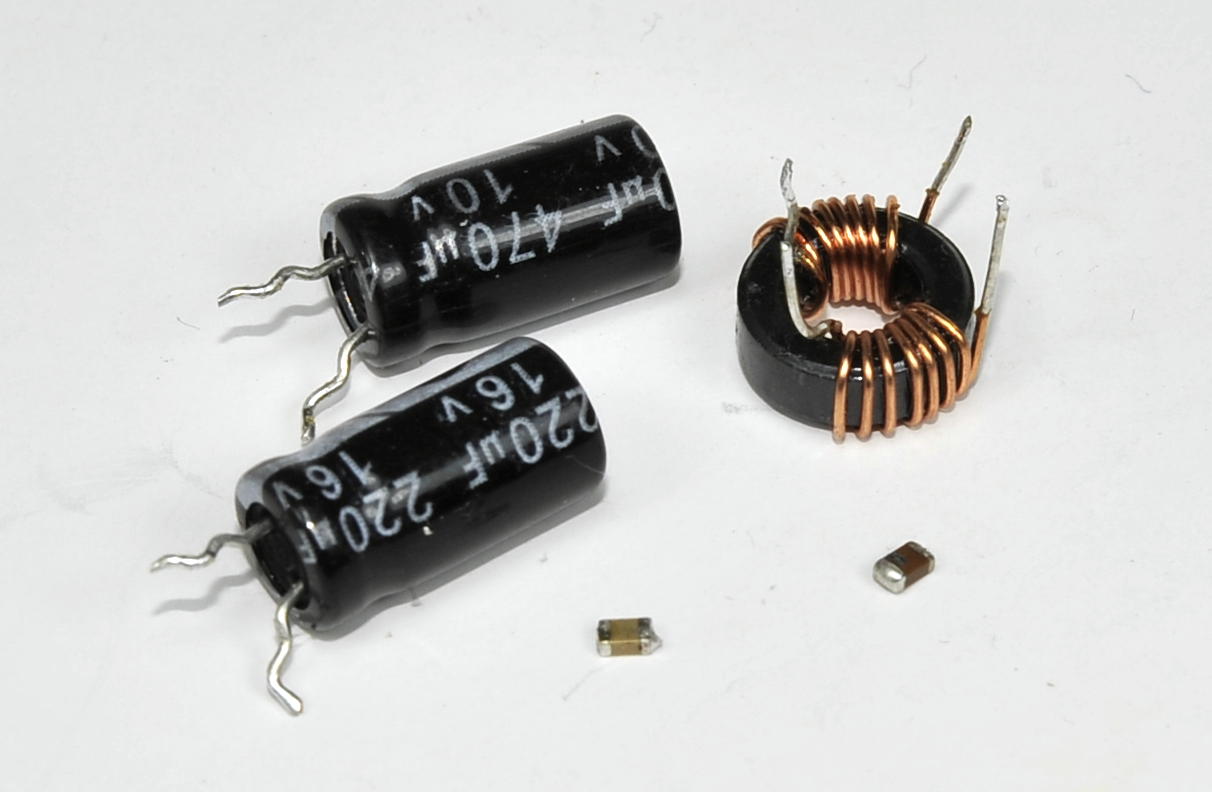

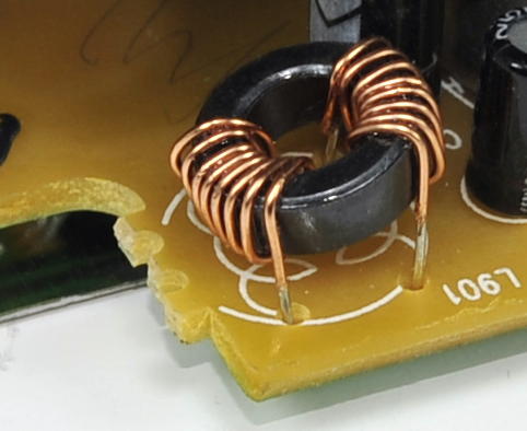

To summarize my most recent mods, this is what I do:
I remove the choke and caps C916, C952

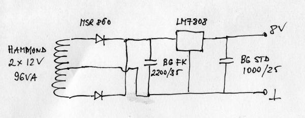

I still use external supply as posted on a first page of this thread. Two wires from PS are connected to the pads where choke was.
I add two output resistors: 300/100 Dale (when building for myself, I use Vishay S102/Caddock) and in place of C916 I instal BG N, either 47/50 or 33/16 depending on availability.

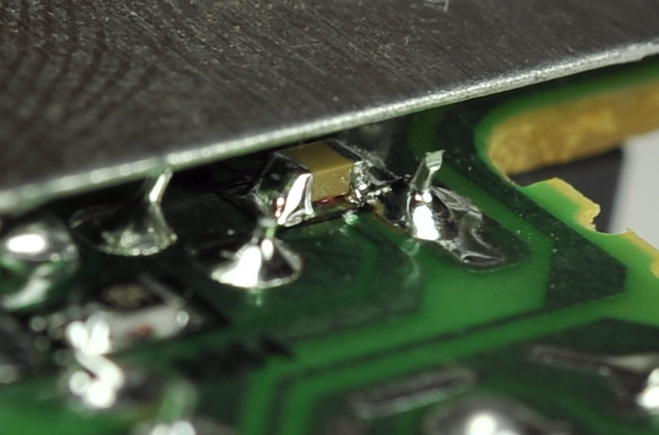

I also remove ceramic bypasses for those two electrolytics, altogether 5 parts.
Peter

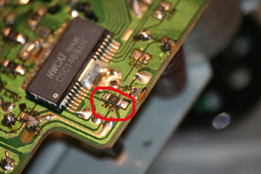

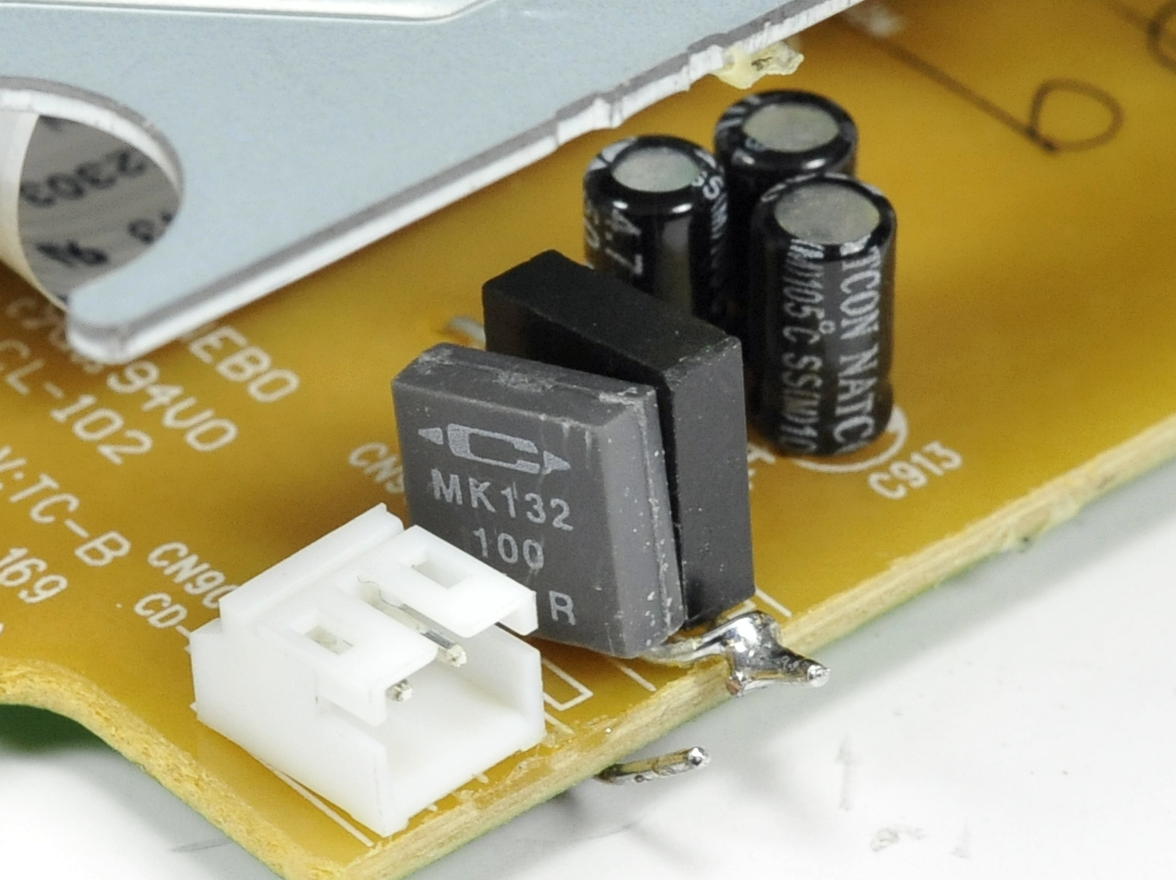

I removed bypass C917.
Is the other one this circled thing marked JW927 ?
I cannot find a C963 as per the circuit diagram.
I replaced C916 with an ELNA 47/22 which iw the closest I have.

Well Solve solved the problem :D
It was an spdif ground loop from my sound card to the Behringer DCX2496.
I just went crazy dont know what was wrong!
Need an trafo to fix it,but it doesnt matter my daughter going to have it
so no need.
