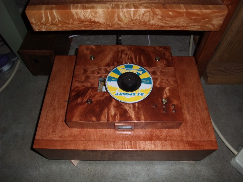

Shigi top
Finally almost finished the top of my shigi. The base has 4 old bricks for mass and it weighs 37 lbs! Remote works and the buttons will be done soon. Seperate PS on the left. It looks good and sounds great. Thanks to all for the great info to make this project sound great! Lots to be learned from this post.

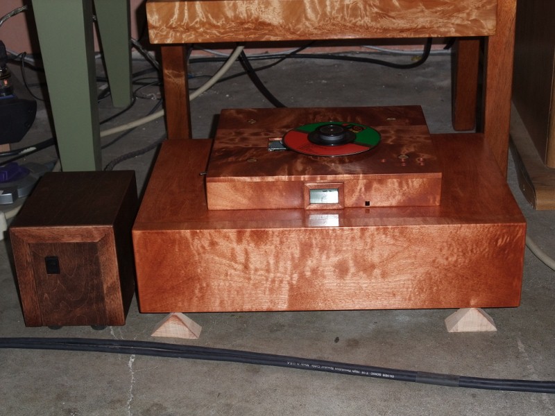

free standing
Today I made an important visual change to the Shiga.
The thick Tunami powercord is now immediately through the backwall....making it look like it is free standing.

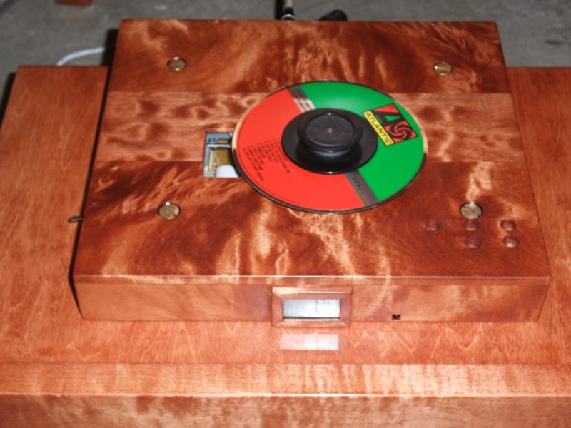

....and a proud close up....
