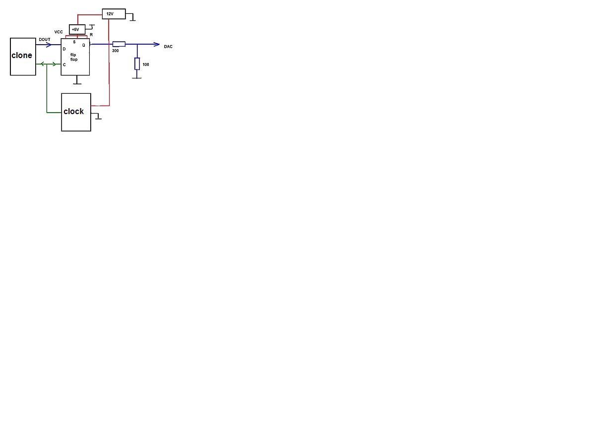

Anyone knows if there's a way to reduce rise time in spdif signal at LC78601E pin #29 (dout)?
I'm not sure how about rising time, but one thing you should avoid is the output overload.
BTW here is the nice output reclocking solution that we tried at Polish forum, similar to Peter's CEC output stage.
If you run your clone with an external clock, all you need is fast Flip-Flop and 5V stab, FF output may be terminated with R/R or impulse trafo.
In my view and few fellows who tried, this single tweak implemented even on "fresh" brand new transport brings more than all other mods put together. And costs almost nothing.

brgds: could you resize a bit, i can't see that sch at all.

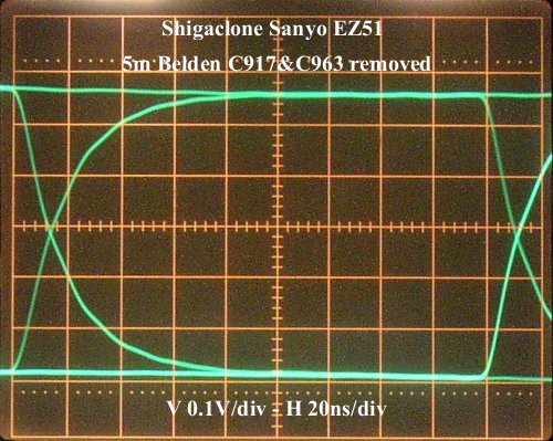

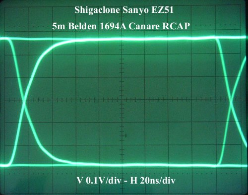

I don't know if anyone has ever been able to correlate the "cleanliness" and "squareness"of the dout signal with the listening quality.
For example Steve Nugent (spdif) said that speed-up rise time is a way to better results.
I'm experiencing something interesting about that, but on the contrary to my expectations.
I forgot to try to remove the two ceramic caps C917 & C963 on 8V supply. Many said that their removing improve the sound.
I did and the sound was improved very much indeed.
But the rise time at the end of the digital cable (a 5m Belden 1694A plus Canare RCAP plugs) was 25ns before and 35ns after with a more rounded trace. The supposed "worst" signal sounds better.
I've to say that at the board level the trace are the same, so something changed at the cable level, why? I don't know. I tried different digital cable, but the pattern is the same.
I'll fit a brand new mechanism (I've a couple for spare) next days and I'm very curious too see what was the starting point.

No one has commented so far, but thanks for sharing the results. It would be interesting to see what has happened to the power supply rails and adjacent grounds since you removed the ceramic caps. I assume there is some inductance present in the trace feeding power to the DSP IC which might account for the reduced slew rate - a clue would be if the supply pins are being modulated by varying current demand in the DSP IC.
My Shigaclone exhibits similarly clean looking spdif signals when properly terminated, and IMO I have not seen too many spdif outputs that were as noise free. A happy accident?
