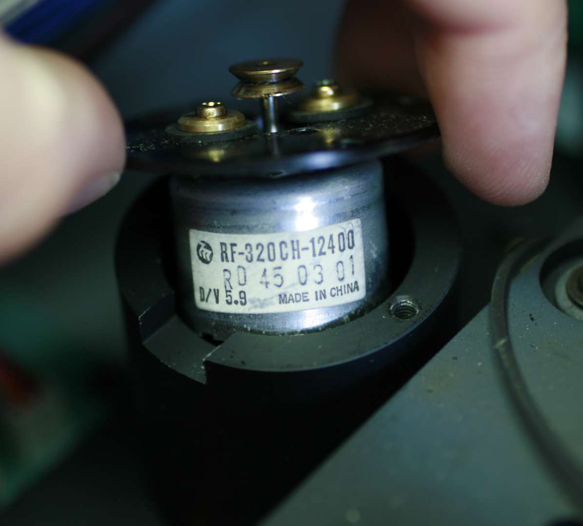

I have obtained and cobbled up 4 different transports in the last week. I have listened to all 4, played with PSU improvements and mucked about with a few decoupling tweaks just for fun. I am having trouble synchronizing my computer based data analyser to compare 90 second long SPDIF data streams from several transports. I have never really investigated the differences in data retrieval and error correction before, but then again I have never used transports I considered to be suspect.
In reference to the Mabuchi (and other clones) spindle motors; they are the most commonly replaced part in CD players (that and loading belts). We used to get bulk packs of 20 from Pioneer back in the day. It's not that the motor is badly designed, it is a simple sintered/plated plate brush motor being asked to do something it shouldn't- be PWM or PPM driven to precise speeds. It is a free running DC motor. The commutators and brushes quickly deteriorate, in fact, depending on the chipset driving them and the agression of the circuitry, they can die in a year or less. Bottom line is they deteriorate from day one. That is why a 'real' transport doesn't use them. Practically every first generation CD player used a slotless, coreless spindle motor, because they knew a)they are better and b)their servo circuitry was primitive and they needed all the help they could get.
All the Technics machines used them (a miniature version of a SL1200 motor almost)
Sony used them
Akai, Kyocera et al used them
The first Pioneers used them.
Philips used them and still do, except in the cheap mechanisms
All the 'expensive esoterica' used someone's transport with quality motors.
What changed? The servo circuitry got so good, you could put a kids toy motor in and it would work. That is what we are using in this situation.
The best transports used linear motors. Why? Because they don't wear out- at all, ever. No gear slack, no broken teeth, no dried up grease, noisy or failing motors.
The perfect relialbility and performance combinations were found when modern servo and control circuitry was used with quality drive mechanisms. That happened around 1987-1990 in Japan.
The Shiga xxxx is none of those things. Just because some 2nd rate outfit in Japan goes all 'Zen' or whatever and packs the cheapest mechanism it could find into a nicely milled block of metal and garners a few pointless reviews on a 'quality' sites like X moons doesn't mean we should go out and blindly copy it.
Don't get me wrong, these beautiful caseworks of engineering art made my true craftsmen and mechanical engineers I appreciate. The elctronic implementation however is very rough in all but a few.
Responsibility here is the key. People are spending real money on making something they 'believe' is going to be good- all with NO evidence. The Shiga original and Shiga clone haven't been actually tested against anything else. I have searched the net for test results and there isn't anything.
That is what I intend to do- test the thing, in fact several of them, and publish the results for all to see.
BTW, the best eye pattern (of the 4 Sanyo 101N lasers)so far came from one transport using the lightweight triple ball spring clamp- the clamp arrangement with a magnet is clearly inferior, extra mass on the motor of even a few extra grams causes a nasty wavering on the eye pattern.
Actually, one of the best regarded and 'expensive esoterica' trasport uses Mabuchi motors:
Care to actually share the name brand and cost of the unit using this transport?

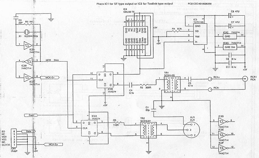

We so often see guys running wild with test equipment, coming to conclusions what a piece of equipment sounds like being biased by measurements. Here's one such, recent, example: http://www.lampizator.eu/LAMPIZATOR/REFERENCES/CEC/CEC TL-1X.html
Anybody noticed what went wrong with this guy's testing procedure (output board schematic attached)?
Amongst other things he did not terminate the spdif signal into 75 ohms which would account for a lot of the nastiness he saw in that spdif signal.
1X scope probe may have mucho capacitance as well. The output gets its ground reference from the device it is driving which is fine in my experience. (I do that too.) SPDIF transformers don't behave too well when not properly terminated.
The other comments about the bass performance were priceless if clueless. Totally unrelated - the spdif stream is de-interleaved error corrected 16 bit pcm stereo digital data (except when HDCD is played when there are 4 additional subcode bits present.) There is very little LF content in spdif.
He does have a point about the spdif, aes/ebu interface board at least so far as the AES end of things is concerned, and that is using both Q and /Q outputs of the reclocking FF the transitions aren't absolutely guaranteed to line up (causing glitches in the transition region of the waveform) - better to drive that transformer single ended and use a transformer ratio that gives you the proper output voltage for AES. (fairly large range of voltage values are acceptable - too lazy to look it up.) It's actually considered to be very poor design practice, but Theta and PSA both did it in various transport designs from around the same time frame.

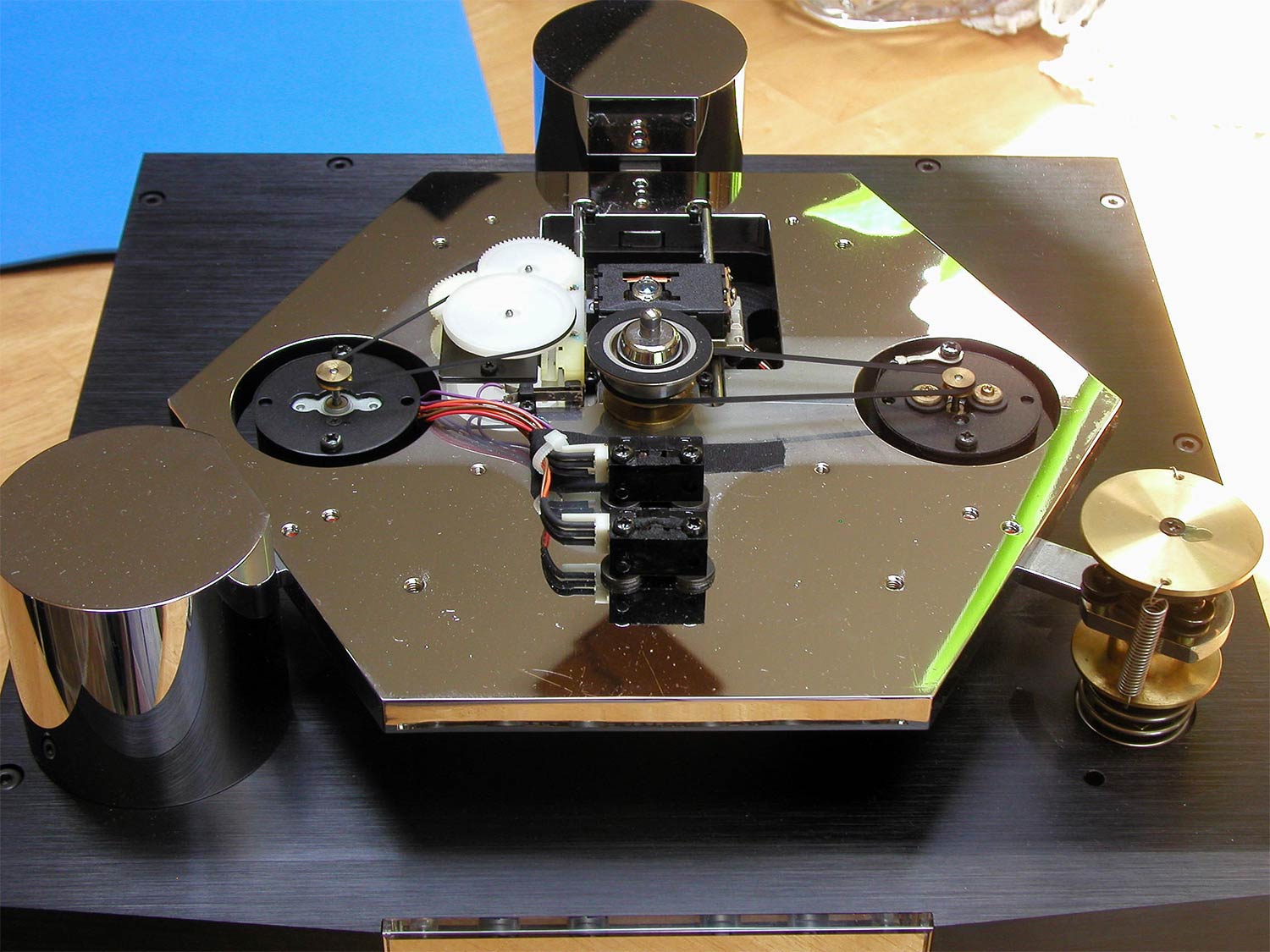

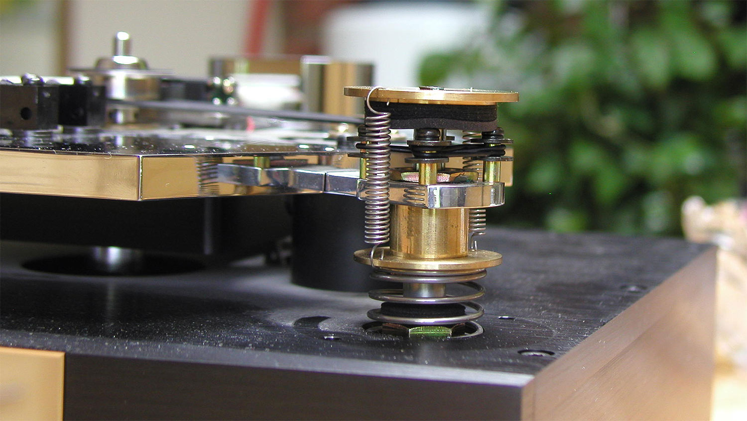

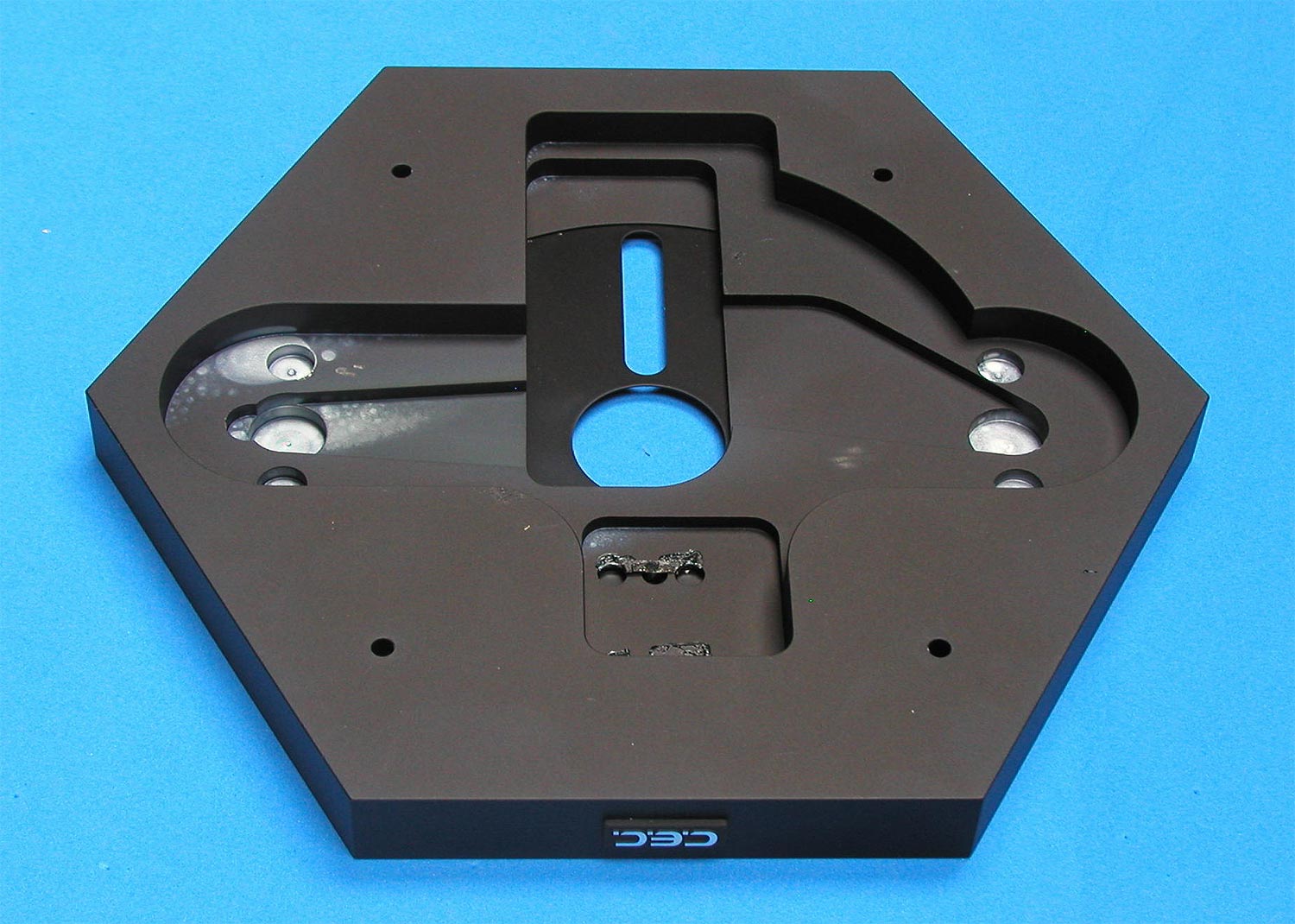

Hi all, after reading about Daniel's discovery a couple of years back and seeing that this thread is alive and well after years of information sharing I would like to tackle this project. My question is, are the JVC boomboxes offered today still the right ones? or where can I purchase my deconstruction boombox and be sure I am not making a mistake? Thanks.
I will post some mechanism, board and chipset options for you.
I have been hunting around looking for current boomboxes that use the same chipset and so far, I have only found one in Australia.
It is is fun project and one I definitely recommend.
The Sanyo laser is history ever since Sanyo offloaded the optical division, however there are numerous clones that all do the same job (pics to follow)
The chipset is also discontinued although chinese manufacturers still have massive stockholdings going into boomboxes, the trick is finding them.
Pics and instructions to follow tonight.

Well, the actual ones that were originally spec;d were the RC-EZ31 and RC-EZ51. One person got the RC-EZ32 to run, but it wasn't easy.
Search for those first. There may be some on ebay. Buy 2 and then you have a spare controller board if you mess it up on soldering. The replacement mechanisms are cheapo on ebay.

The mechanisms on eBay are mostly cheap copies of the Sanyo. The all look the same but are definitely not. The mechanism hasn't been made now for some years with the Sanyo markings. Most have no markings, or just 101N.
To whom it may interest, I have seen lots of the original EZ31 on the shelves at Zellers in Canada. They still do not seem rare here in Quebec as I've seen them elsewhere also.😎
Unfortunately Zellers online arm does not sell into the United States as I discovered to my chagrin when I first started working on my clone.

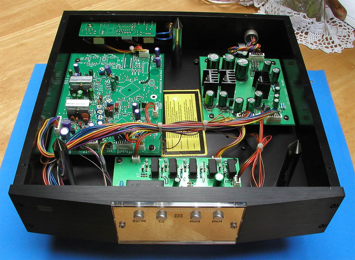

I'm the one incidentally who built one with the RC-EZ32 - still works just fine. Was not that easy to get it working, but the details still exist in the early part of this thread if you happen to find one of these.
