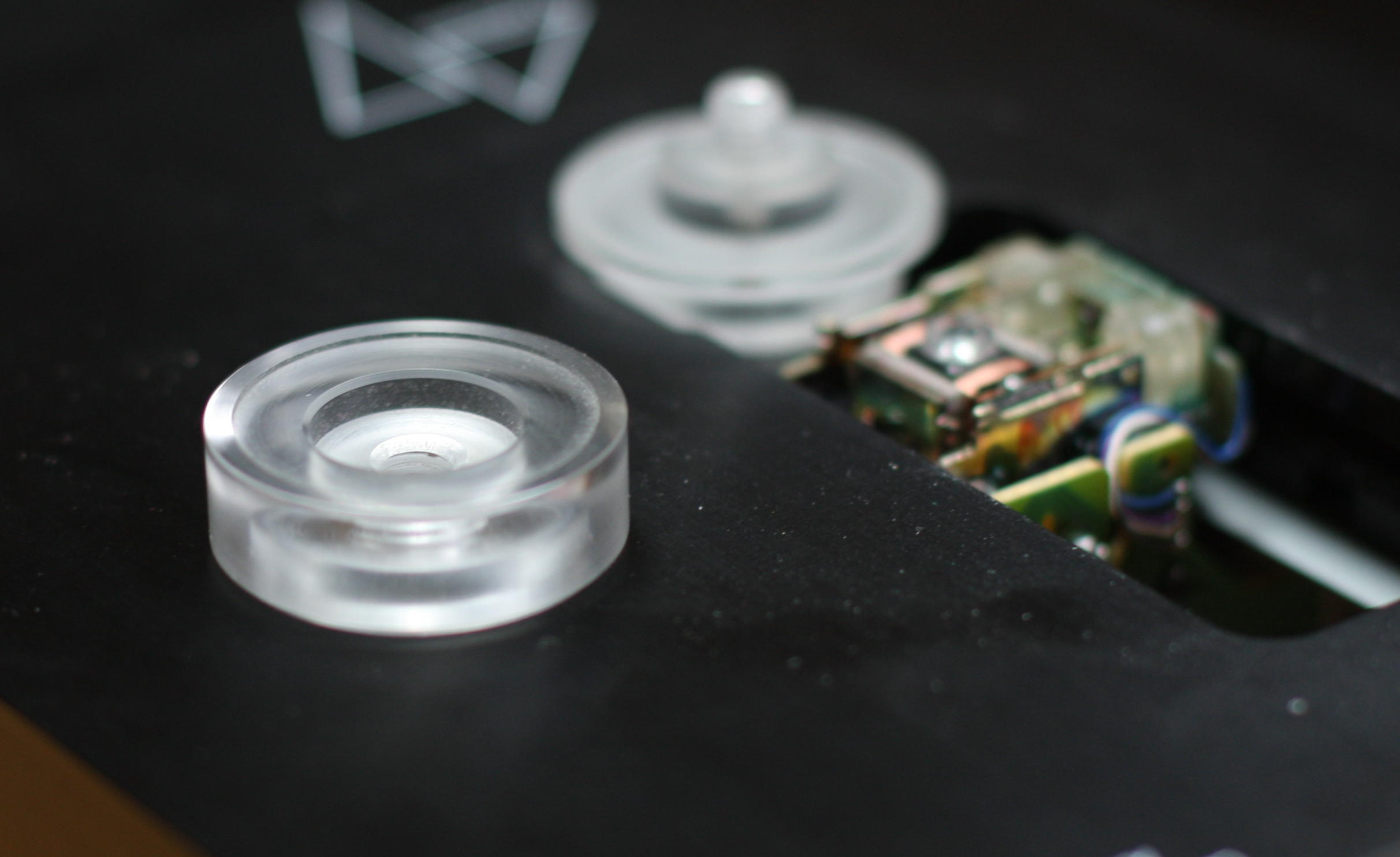

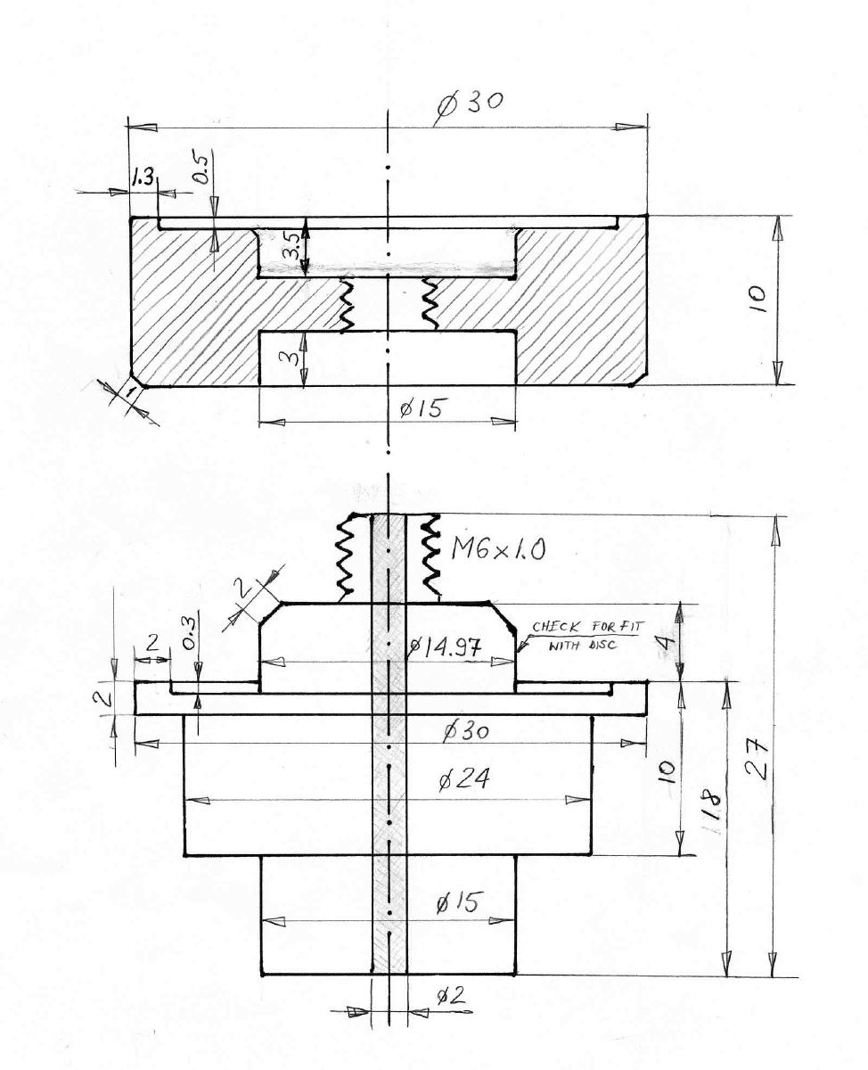

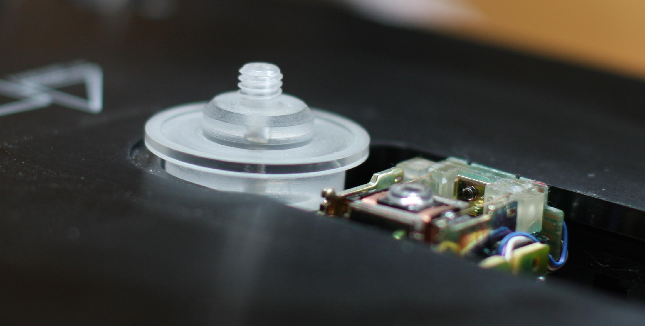

Lovely Peter.
Have to say I admire your filing system. You always seem able to post that exact pic that we need. 3 cheers.
Fran
