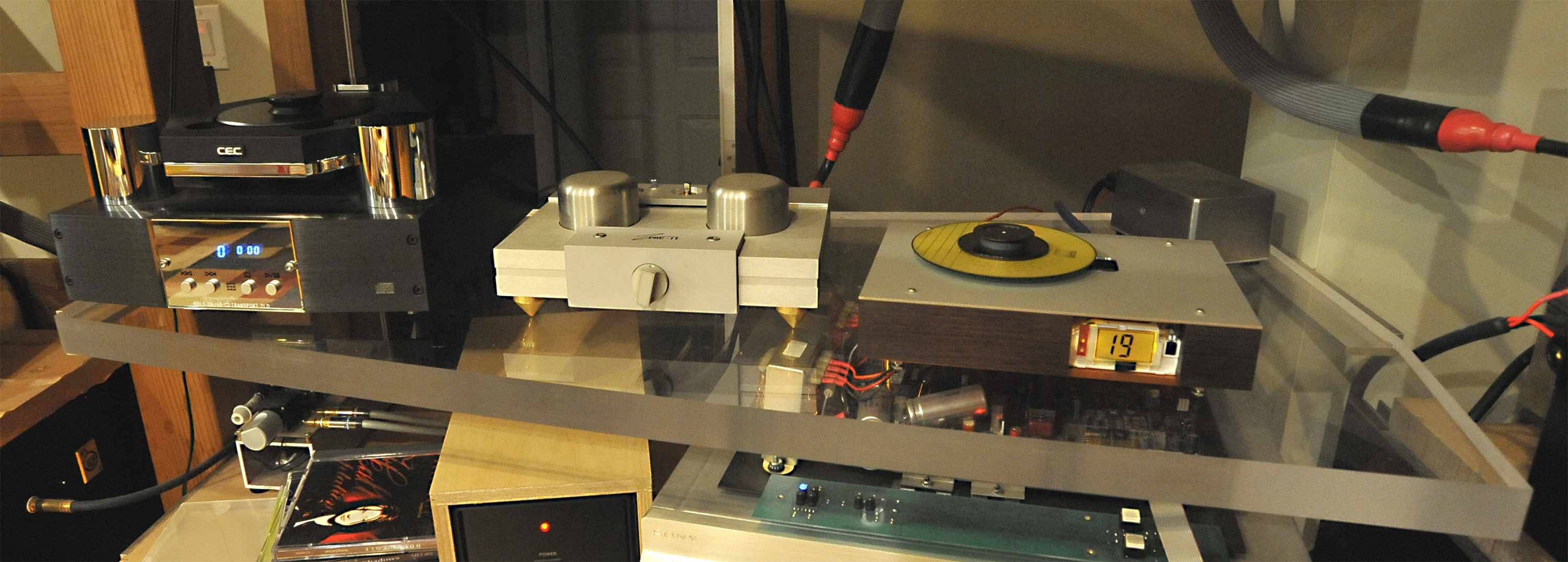

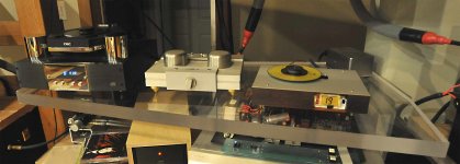

YESSSSSSS....
Your puck came in....😎
No deviation what so ever...you' ve done it

Hi Fran,
My puck arrived tonight, and of course you know it was with great excitement that I rushed down to ye olde man cave (should that be bat?) with the new puck. 😀 I am delighted to say the installation was intuitive and you know what - I really like it. I think I can hear a subtle improvement in sound, but it looks two orders of magnitude better than what was there before!! And it is really easy to use and works just fine with my Herbie's Audio Lab (yes that's a plug) CD mat.. 😀
As you probably remember my last experience with machined pucks was not a happy one, so I am happy to say this is just awesome.
Thanks again for including me..

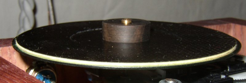

I received Fran puck last week.
Thank you very much.
From a mechanical point of view, it's perfect. Really a good job.
I was able to fix the problem I had with the stock puck. It was not centered therefore introducing a wobbling movement on the disc.
CD spins flat now.
About the listening side: it seems to me that Shiga delivers a better sound now. Nothing outstanding, but music flows more easily, more natural. I think it's related to bass frequencies, they're tighter and more extended.
Fran's puck has been an improvement for me. Thanks again.

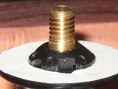

One of the fellas was asking about how to make the puck and insert so heres what I wrote to him:
First the brass piece:
I made this from some 8mm brass rod. I used a lathe to turn down the diameter to 6.05-6.08mm. This is the size you need to fit snugly into the existing platter on the mechanism. Then turn down a part of the end to a taper and use a die to cut an M6 thread on the spindle. 6.1mm is a little big for cutting an M6 thread, but take time and a little care it will cut ok.
You want the wood puck to screw up easily on the spindle in use. So what I did was go back over the threaded portion with some sandpaper to take down the overall diameter a little. Its no harm to give it an extra pass with the die after this either. Check it with a M6 nut - it should spin up on the thread very easily.
Wooden puck:
I used ebony, but you can use really any even density timber that will take a thread. Things like african blackwood, cocobolo, box, lignum vitae, and so on all will take a thread.
Turn it over size and drill a 5mm hole in the centre. I tapped with an M6 tap at this stage, but you don't really need to. Leave the roughed blank aside for at least a few weeks (indoors) or better still even longer to equilibrate.
Then come back and re-tap that M6 thread in the centre of the puck. I made mine to the drawing from earlier in the shiga thread. Do not be tempted to make a big puck - make the smallest one you can get away with. Overall outside diameter is slightly smaller than platform, about 20-25mm. Recess inside is 3mm deep and 15mm wide, although once it fits over the cone shaped part of the platform, it will be fine.
You will need to make a mandrel to hold the puck as you make it. I made one from some aluminium with a M6 threaded portion. That way I could spin the puck up onto it and turn one side, then reverse it and turn the other side with rebate etc.
Last thing to do after turning etc, is to go back and use a coutnersink to slightly (1mm) the tapped hole. This helps the puck to spin up a little more freely. After that another pass with the tap again. No harm to leave the puck again for a week or 2 and give it another pass with the tap again.
If youa re buying taps tp make the M6 thread, do yourself a favour and buy a set of 3 (ie starter, middle and finishing taps) and a couple of the right size bits for drilling ( It hink thats 5.3mm).
Make a few blanks when you're at it, most likely out of say 5 you will loose 1 at least. Pick wood that is even, ie don't get some of that (admittedly beautiful) african black or macassar ebony with the heartwood - it needs to be as evenly grained as possible to be as stabe as possible. You will only need a small amount, so buy some instrument grade stuff.
Its all easy enough once you do it once or twice.....
Fran
