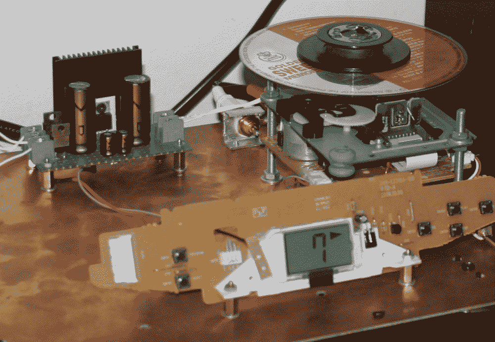

leoparleur said:Hi Shigaclone is coming slowly.
Can someone explain me the use of this black cable and staple to the clear lens? Can I remove it, I'd like to put the display right against the rear of my stainless steel front panel?
Thanks,
Guy
Morfeus said:
this is exactly what the cable does. I wouldn't remove it.
I believe this has sense while in original plastic boombox. Huge plastic box might accumulate a lot of static electricity and then shift it to the display glass.
However, once removed from plastic box, and mounted in metal or even wooden box, static electricity has no influence at the display.
According to that, no grounding neccesseary. I did remove that from mine. Nothing wrong happenned in last 5 months with.
Leaving that wire in place will not hurt either.

Thanks dzuvela, your input is very welcomed, I'm taking it in consideration.
Guy

we tried that, when we mounted the display in a metal case and had problems when removing. So we put it in place again.
What kind of problems exactly?
Flickering display, numbers only shown partly. As soon as we re-installed the foil and the earthing cable everything was fine again. We did not have contact problems.

Morfeus said:Flickering display, numbers only shown partly. As soon as we re-installed the foil and the earthing cable everything was fine again. We did not have contact problems.
I see.
Thank you for that information. It is worth to know for everyone here.
What I did in my shiga-case, was to remove display from orignal PCB with other elements, and mount all at custom shaped PCB (experimental type with dots).
I really don't remember if plastic folie was removed, but I am 100% sure that grounding was.
Admit that I am not informed in details of how LCD operates. Since I got no problem with, thought that LCD grounding is not important.
Morfeus, thank you once again for sharing your information.

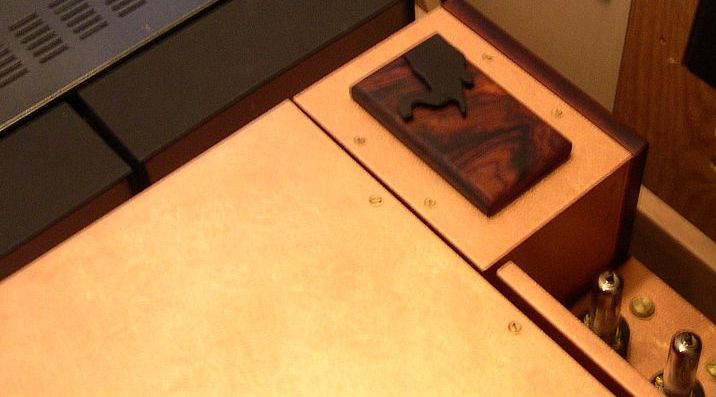

To get rid of the magnet in the disc clamp, use a stainless steel disc with same dimentions and aprox. weight....it works fine...

The big question is does it really make any difference to the sound?
This is the big question indeed. I am currently using a screw down clamp made from ebony. There were some issues with my first one being stable (ie it warped) and one I sent Erik warped too. However, I do think it adds to the sound - but not hugely. In fact I had promised one to m.massimo too but have not got back to finishing them yet. Hoepfully this week guys!!

Fran,
Try and get hold of a block of carbon in as pure/fine a grade as you can and turn it down...it will not warp and you will be amazed at how much better it will be than even the hardest densest wood.
It is quite expensive and easy but filthy stuff to work (WEAR A MASK AND GOGGLES). I simply do not know who is a supplier in the British Isles, but Audio Teckne in Japan use it as body material for MC cartridges, as did Be Yamamura. Both even made complete turntable systems from carbon.
Good luck.
Indeed there is a noticable difference using the ebony in comparison with an acrylic puck.
The ebony has a sweeter projection even when it is still slightly wobbeling.....the test with violins is revealing.
If you give it another try, I have all the patience in the world Fran...take your time...😎

Yes, Erik, patience is good - but a kick in the *** to get moving is good too!!
Anyway, m.massimo and Erik, here is something I'm sure you gave up on:
I'm going to send one to Peter Daniel and Kevinkr as well because of their large contribution to this thread and the enjoyment we all get from our shigas.
Peter, I have your address from some of the stuff I have got from you over teh years.
Kevinkr - can you pm your address if you want one of these?
Fran
