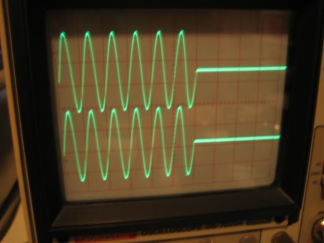

here are a few of the scope shots:
tno_99 displaying the maximum number of tracks on my test disc
toneburst showing a 1001Hz EIA toneburst

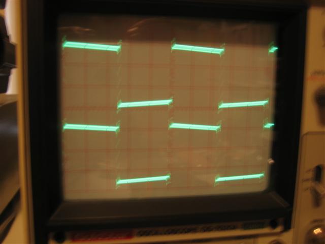

square 100Hz Square wave

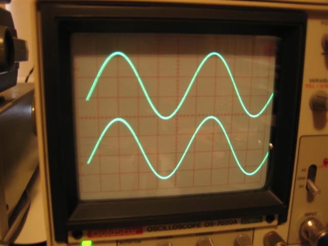

18kHz sine

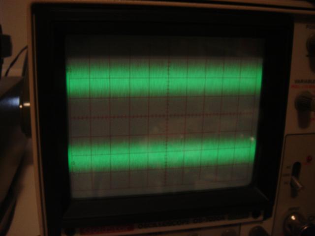

-60dB 1kHz -60dB note there is essentially very little except noise
All other tests used the DENON 1984 original pressing 99 track digitally derived digital audio test disc.
18kHz sine

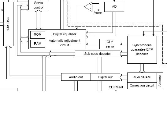

Peter, the 94A29FAG (great suffix huh) is no good to you. An amazing chip but no digital out. That being said if you can hack out the cd part you can at least build a banger that won't sound too bad.
I have attached the part from the datasheet and you can see the digital goes straight to the 1 bit DAC. 🙁
