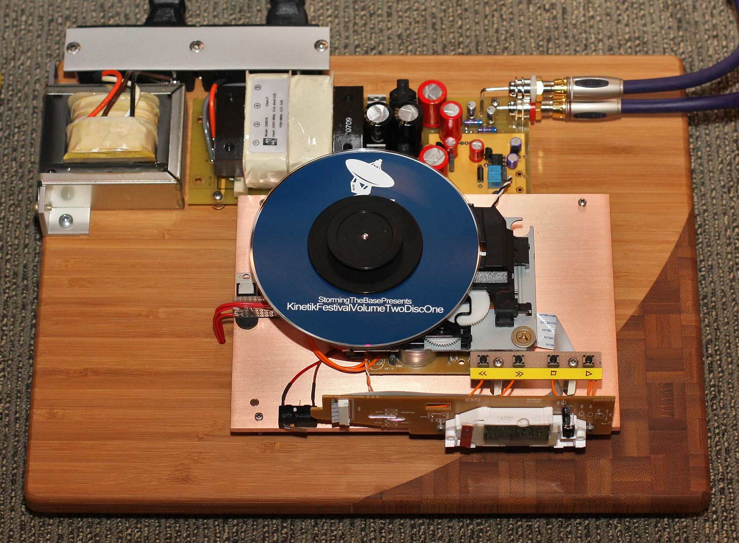

All in one
Hi Peter,
I have a EZ51 on its way and have to decide which route to go.
Your All-in-one player in post 3406 did get much reaction. Can you expand a bit. Do you see advantages, improvements? Did you make a housing for it?
I just completed building all-in-one player and it sounds surprisingly good. Seems like getting rid of digital interconnect has advantages.
Hi Peter,
Well done.....
now, how does it sound?
Fran
It is a bit dark - deep bass, soft, almost analogue like. There is some authority and relaxed feeling about the sound I would say. I will wait for a while before doing any judging. However I will get another one and do a step by step mods with more critical listening between the steps.
That's what you get when using too many BG N caps. It was also one reason I switched to more "simplified" version: it's more intense and live.
It was a unit I built for a customer. AFAIK, he was very happy with it.
These days I'm not too finicky about appearance and prefer to build it fast and efficiently. Those would be advantages, as to improvements, it depends on a listener.
If I would be doing it again, I probably wouldn't change anything.
One thing I forgot to do was to remove the ceramic SMD caps at the input - after that midrange improved considerably and sound opened quite a bit. I also got another boom box to do step by step mods. It is obvious that clearing the PSU input from ceramics and choke is very important.
