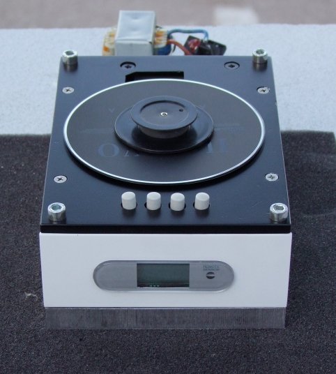

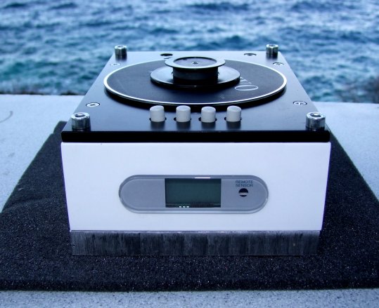

sparkle said:dzuvela.... you were busy..... 😀
nice looking....!
sound??
satisfied??
thank you sparkle
Yes I am satisfied. Waiting for new digital and TOS cables. then I will do some more experiments with those two interfaces.
Analog output level is significantly lower. Couple of tubes would help here a lot.

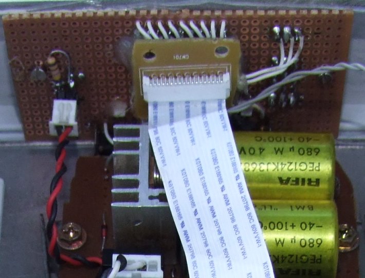

dzuvela said:bottom look.
Display panel with remote sensor and backlight diode completely redisigned. Only ribbon conector with piece of original panel board cut mounted on new board.
Power suply board is also new.
If that Rifa PEG caps i see?

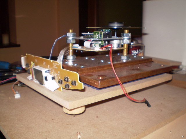

sparkle said:at my place, the "thing" is currently looking like this..... 😀
BG cap's on the pcb added, new power supply burned in, moving forward a bit with the mechanic stuff....
I am glad that your BGs are finally burned on. I am using used RIFA. So they are definetly burned 😎
Need to solve door switch mechanic yet. There is REED contact now driven by litle magnet.
Base plate is cut, 15 mm Al plate. Yet need to be driled for bolts and spikes.
Generally, I can say that whole thing is assembled from vasted materials and components.
Recycled parts, but sounding great.
