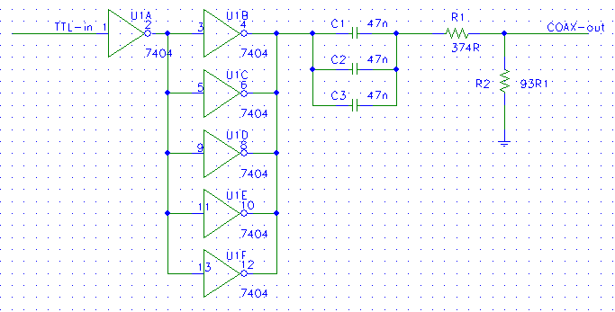

has anybody any idea how to buffer the signal for the digital out....??!

Why you would buffer that anyway?
I made some meausurements with osciloscope. Signal is pretty ok on both ends.

There is no need for 75 Ohms exactly. Digital out don't care if it is 50, 75 or 93 Ohms or any other. So you can adjust impendance to media and connectors you have. E.g. you can use BNC 50 Ohms RG 58 coax.
The problem can arise at external DAC input if this can't be changed. So you need to stay with 75 Ohms.

There's no need to do that, the Dout signal is capable of driving the load. But if you'd still want to buffer it, in the attachment you will find one way of doing it. U1 is a 74HCT04, C1..C3 can also be replaced with a single 150p cap.
I simply use R1 and R2 directly on Dout and GND.
Yes and no. If the complete chain is 50, 75 or 93 ohms, you're correct, but mismatching in- and outputs will lead to reflections. Altering a 75 ohm input of a DAC would definitely not be my first choice as the circuitry behind the input may also need to be modified.
Real life is never perfect, so achieving exactly 75 ohms is unlikely, but 50 ohms will be a heavier drain on Dout than a 50% higher (i.e. 75 ohms) impedance.
IMO, the Dout signal in combination with the layout of Dout, GND and Vcc on the pcb has "Toslink" written all over it. You could just solder in a Toslink transmitter (TOTX177) and it should work. It's not designed for coaxial S/PDIF. Adapting it to drive a coax at S/PDIF levels (500 mVpp) and 75 ohms impedance is (just) possible, but 50 ohms might be too much for the Sanyo IC without some buffering. Buffering equates to extra components which I'd rather avoid.
Safest and simplest is to stick with 75 ohms.

Thanx, this is useful info. As I have a DAC which also has an AES/EBU input, I was thinking of converting the output of the Shigaclone to balanced mode...
This is what I mean. Whole chain the same.

Yes I can agree, 50 Ohm may be to low for Dout. According to the datasheet, Dout works at 12 mA and voltage is beetween 0,1 and 0,9 of Vdd (5V in this case) depends of Hi Lo signal state. There is no data about maximal current or minimal impendance as I've seen.

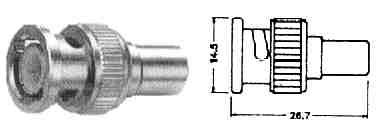

It's happenned that I have rests from company old network coax ethernet and Arcnet which are 50 and 93 Ohms respectively. This includes BNC connectors, "T" elements, cables and terminators.
Temporary I will adapt ext.DAC input from 75 Ohms to "no impendance" . At transport side, Dout is not terminated yet. Connections on both ends will be "T" ends with terminating resistors of BNC type. This is kind of BUS connection.
I am just curious what I can get here. Even more, it is possible to change cable types and resistors and see if any difference. (93, 75 or even 50 Ohms)

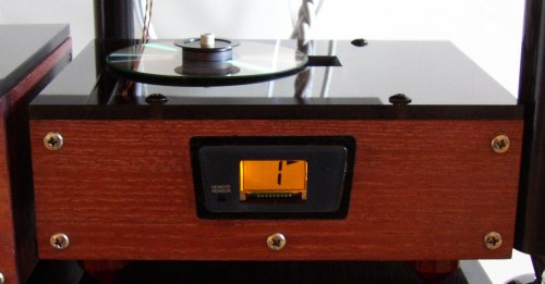

Build no. 2 is going well, all the mods are done to the mechanism now and the casework is almost finished.
This one is simpler in many ways than my previous one. Its isn;t suspended right now - although I may add that later. The transformer is in a separate box with rectification/regulation in the mechanism box. This mech came from a EZ-51 and the smaller display board is much easier to house. In this one, the board will just be mounted behind a new fascia and I have some buttons made that will just attach to the buttons on the PCB. Other than that its pretty standard....
And the baseplate it will sit on:
That baseplate is some kind of ceramic compostie material. Its really really heavy and I hope my wet tile saw wil cut it to size. I have 2 blocks of it and I may end up using the other one yet. Its too big right now so I need to cut it back to fit the shelf.
Fran
Fran
