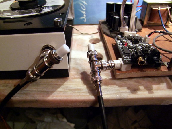

Looking for some input:
I've put together shiga no.2 and have hit a snag: When I push the TOC button, it searches but can't read the TOC - I just get 00 on the LCD. Once or twice it did actually read it for me - but when I hit play, it stuttered a lot on track 1. If I skipped forward to track 2 it plays smoothly.
It seems like the mech doesn't like the inside of the CD but I can't see anything interfering with its movement (stop switch being hit correctly)!
Anyone have any ideas?
Fran
Fran
TOC or DOOR switch shold be openned then closed and stay closed for sure, how reading procedure can be finished properly. New openning of switch makes reset and new reading should follow after closing switch again.
Check your switch again.
However there is also possible that you have damage at PCB. Check tiny lines by inverse rounded cornes of PCB. There is one corner specific. Don't know which one. I should open mine to see exactly.
Thanks Dzulvela will check that, but I don't think it is this. I hit the TOC switch and the mech moves to read the TOC, but stays reading it for quite a while before giving up and displaying 00. Not the same behavious as when there is no disc in place. If you do this with no disc, the disc motor spins and stops, spins and stops. With a disc in place on mine, the disc spins up, the laser sled moves into place and I can see the lens trying to track. All seems fairly stable. Its like as if the laser finds what it thinks is the right spot but the lens can't see the disc to read it.
One thing I did notice is that the gear wheels seem a lot looser on this mech than a spare ebay one I have here. I wonder if there is a little too much play in them and that this is what the problem is. This one came dissassembled to me so maybe it got a knock or something somewhere along the line.
Tomorrow night I will look again at it. Maybe swap in the new mechanism. Any suggestions much appreciated.
Fran
OK, couldn;t resist having another look at this.
So I don't think its the crystal. I installed a different citizen one - no change, went back to the original one - no change.
Half the time on first power up it will read the TOC but when it starts to play it seems to have difficulty getting going on track 1. After that it plays silently and no problems. If I then hit the TOC switch (ie when already powered on) it never successfully reads the TOC and I just get 00.
The other thing is that when I look closely at the laser lens it seems slightly cloudy (laser off of course) - thats in comparison to my spares here. I also found a hair in the laser assembly. So I don't know, maybe thats where the problem is. In any case I think tomorrow night I will try the new "spare" mech and see how it works out.
BTW, I did search and the only post I could find was from Peter suggesting that problems reading the TOC and skipping were down to the crystal. I think though I've eliminated that.
Any other ideas gratefully received!
Fran
