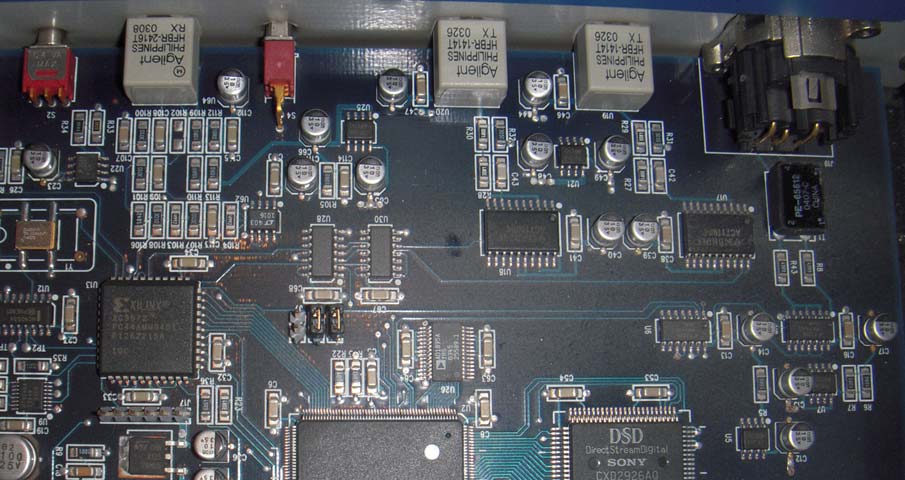

with a little delay, but like I promissed
EMM lab CDSD model
fibre optic photo...
uses
aglient HFBR-1414T tx and HFBR-2416T rx
useful web-loc where you can get very good infos how to implement
fiber optic link...
http://www.avagotech.com/pages/en/optical_transmitters/token_ring/hfbr-1414/
cheers

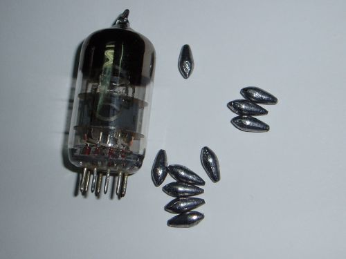

i bought some accessories for my Shiga... the tube is a gift from a very good friend of mine - it is for digi-lampizator that i would like to try on the Shiga... 😀
the weights are 1g each...
